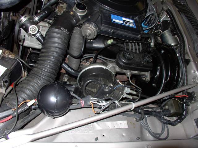

My 1988 Chrysler 5th ave has had some loss of vacuum to the HVAC system upon acceleration, resulting in very low airflow from the panel vents, and then letting off the gas the vent air returns to normal. I used a simple fix for this and so far it is working for in town and some highway driving. Here is what I did. I bought a Dorman #47076 vacuum canister ( $12.99 Autozone), Dorman #47380 vacuum connector assortment ( $7.99 Autozone) , 1'- 9/32" rubber vacuum line, 6'- 7/64" rubber vacuum line. I connected the 9/32" rubber vacuum line to the Dorman vacuum canisters larger port. I then used a 1/4" to 1/8" connector to reduce it. Then push on the 7/64" rubber line to the 1/8" connector end. Pull off the original 1/8" black rigid line going to the rear intake manifold multi port, and push on the new 7/64" rubber vacuum line to that port. Then push on a piece of the 7/64" rubber vacuum line to the smaller port on the vacuum canister. The other end gets pushed on to the original black rigid vacuum line you removed from the multi port at the rear of the intake manifold. This canister was chosen because it fits well under the hood, and was available locally. I left a little extra line to relocate the canister if needed. Note the temporary red twist tie. The round plastic ball is the new vacuum canister. All together the cost was about $25.00. I hope it keeps working.

This was the exact same factory solution that Chrysler used on the late model Grand Wagoneers when they unified the heater, and A/C controls, and made it a vacuum actuated system. This big ball lived right on the Jeep firewall, and worked like a champ.

Master M
Nov 22, 2014
330
117
I replaced the vacuum check valve under the dash first, but it didn't take care of the problem all the way. When I put the vacuum ball in, that fixed it. I may have a slow loss of vacuum somewhere.
