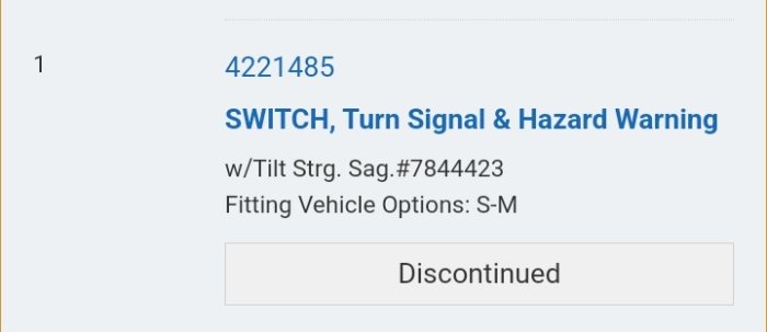

Can't find this Mopar part in my books. My parts books have been coughing up pages for too many years and can't find the #. Turn signal switch, but found conflicting different years 77-80 or 85-89 and nothing says if its tilt wheel or not. Any help is greatly appreciated. Thanks

Expanding a bit on post #2:
4221485, or 04221485, is a turn signal switch for the following vehicles with Saginaw built steering column# 7844423:
1985 - 1989 M-body with tilt steering, including later models with air bag (active), without cornering lights.
1985 - 1990 S-body (Dodge Caravan, Plymouth Voyager, Chrysler Town and Country mini van models with tilt steering.
Superseded by 4373412, which was released for 1988 - 1990 J-body (LeBaron) with tilt steering and air bag (active), plus supersessions 1988 - 1990 M-body and 1988 - 1990 S-body. Also used in 1990 D-series, W-series, and N-series (Dakota) trucks.

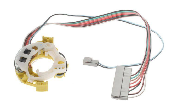

Standard Motor Products lists a replacement, part number TW-48, for these two Chrysler numbers.
Standard TW-48 image:
