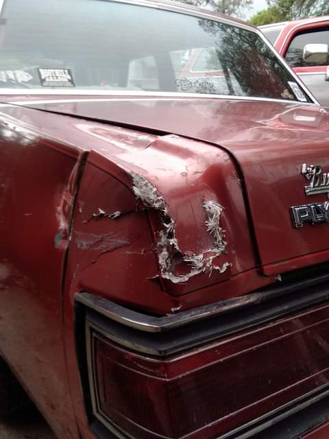

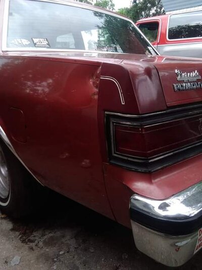

After poking around for quarter panel fillers and seeing what a pain it is to buy driver side ones, I went and bought a passenger and a driver's side. The part hoarding has begun.
