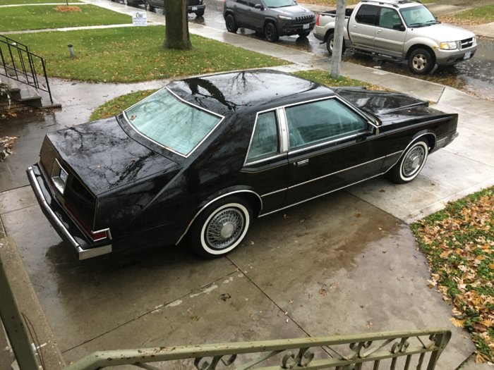

It's bubbling in the top of the C-pillars, bit of rust on the trunk, bit at the bottom of drivers door. Also all the headliner material has gone crappy. Fuel injection long gone and looks like it's converted to regular electronic ignition (not using the lean burn) What kind of $$$ you guys think it's worth? Hard to compare ... don't see any for sale.
Not sure what kind of ugly will be in those C-pillars when I start grinding.

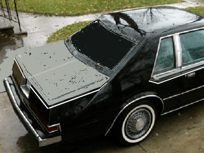

There's an interview with one of the guys who worked on the 81 Imperial body design on the Imp Club website. He said he'd like to see a good two tone paint job on one of them sometime. So.. .uhh.. I .. uhh.. kinda used your car...
