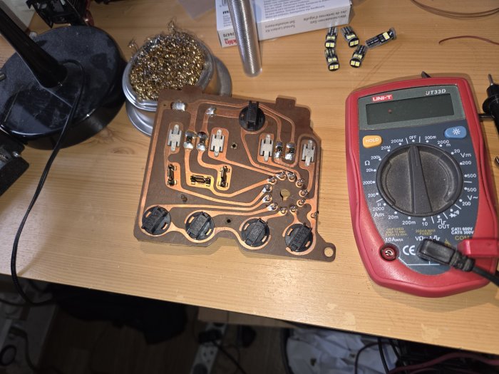

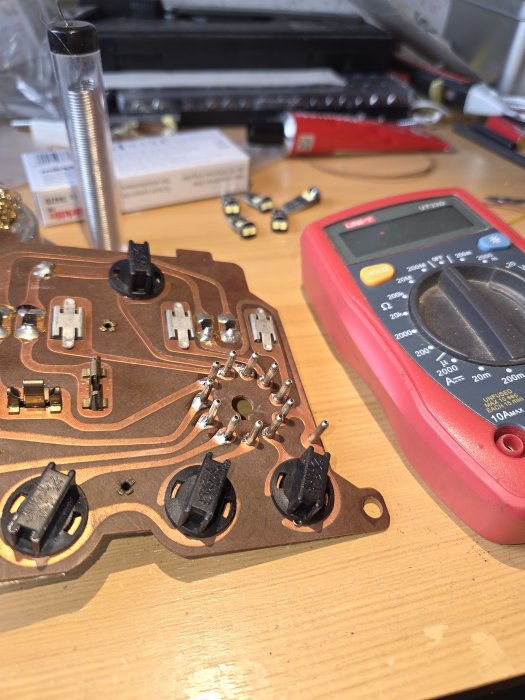

Having said that I had trouble with the instrument panel not working as it should. The voltage regulator packed in (what I thought!) as the fuel guage an temperatur
stopped working. Well, I took the minor printed circuit board out and put my glasses on. Checking everything over I found that the pins for the connector was not up
to my standard. They wer loose and flimsy. The soldering Iron came in handy and a quick fix soldering them carefully to the copper did the trick. A voltmeter told me
that they were on and off when checking the resistance.
Now it is even better than new as I put it back and lamps and all worked. I have changed all bulbs to LED by the way as once dismantled a few minutes extra to change
them and the holder.
