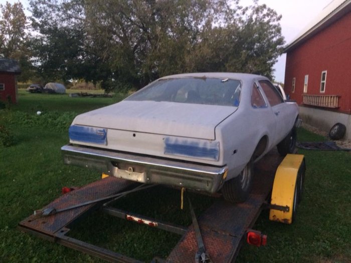

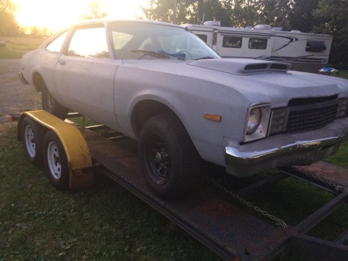

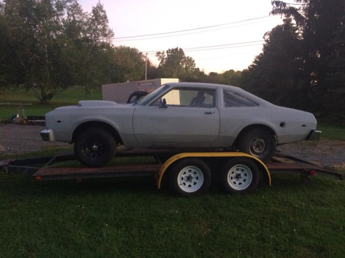

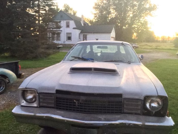

My latest endeavor, and what has drawn me here is an f-body bracket drag car, I dragged a few times, then started on some circle track stuff, then started supporting the wife's racing habit and kids got in the way and we been circle tracking. That seems like a dying sport honestly especially at the asphalt street stock level, so decided at this point to use some of my stored up inventory and build a mild build bracket car. I bought a major project / parts car then a second more logical builder (which will utilize car 1 to bring to fruition) so here is the first purchase.

Welcome aboard!
We enjoy pictures of all cars here (and I have owned a lot of the same ones, myself).
I like this picture. It reminds me of a Craigslist sales ad of a rust free car (because the seller cut out all of the rust . . .).

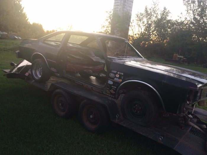

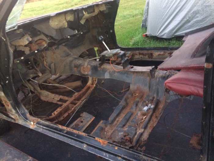

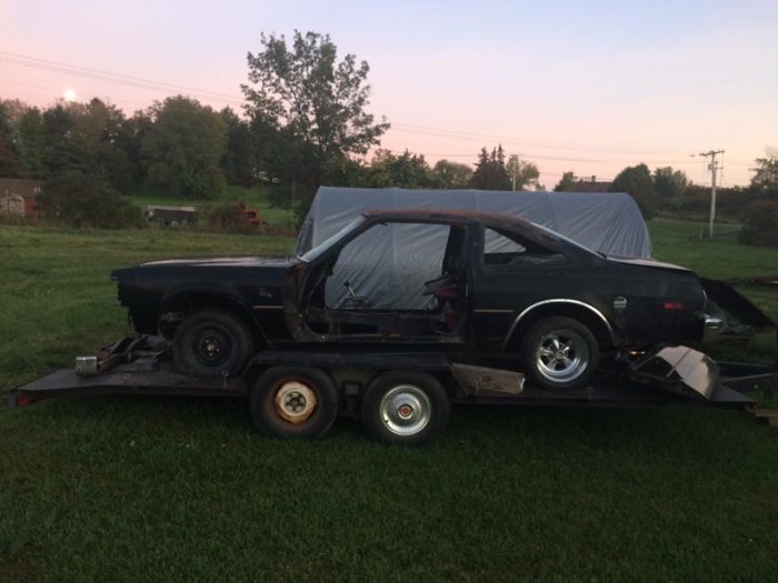

This one became a parts car for his other which apparently had a nicer shell but really bad floors, I will use what I can for parts from it, not much, but there were a few gems, the hooker headers and Holley electric fuel pump, the rear end turned out to be not so much it was supposedly dragged and has a suregrip but is the 2.26?? Ratio, so got my money out of it, not sure what will happen with the rest of the shell (for now it sits with my other parts cars), my feeling is best to go to a circle track guy
1,492
Not very many F-bodies (if any) got a 2.2 rear differential (7¼” or 8¼”).
With that said, most of the M-bodies (85% plus) did get the 2.2 ratio rear differential (7¼” or 8¼”). I suspect that might not be the original rear differential for this car.
Before doing with the blue (or black) body, before to remove the wheel well trim! Those pieces are hard to find.

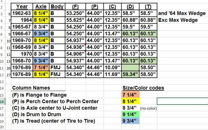

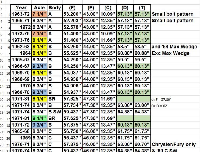

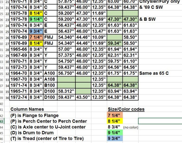

The chart below is one of the most correct ones I have ran across – and it is far from complete. I have pages of additional and updated information. Also I have a lot of information on newer vehicles to add to it (one of these days . . .). The green cells are data I’m missing or not 100% sure is correct.
When done, this spreadsheet will be about twice the size (or more).
FMJ-body perches are 44.46” center to center. 65-70 B-body perches are 44” center to center. Most leaf springs will "give" ¼” per side to fit in.
Pretty much all other differentials will need modifications to fit (perches cut off and added, width, etc.). Technically, an earlier B-body Dana 60 will bolt right in.

Thanks for the additional charts.
1,492
All F-body, M-body and J-body differentials have the same differential width and will interchange with each other in the FMJ-body camp – including the 7¼” and 8¼” – except for driveshaft length is slightly different, and some early F-body 7¼” differentials have different tube diameters (which means the U-bolts and the leaf spring clamps are different on them).
The Late ‘70’s 7¼” differentials have larger tubes thereby sharing the 8¼” U-bolts and spring clamps (Iso-Clamp).

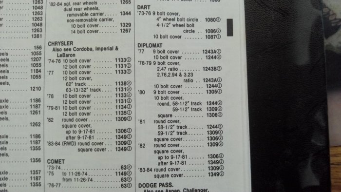

You are testing my memory now, it has been 25+ years since I went through this last time, and time and miles may have taken a toll on my memory, I'll have to see if I have notes, but I do swear that when I swapped out a 1978 F body (Volare wagon)and put in a 80's M (cop car Diplomat? (It had a suregrip with a livable and swappable ratio of 2.76) and I swear it was live about an inch wider but memories aren't always accurate, so, I'll look. Thanks

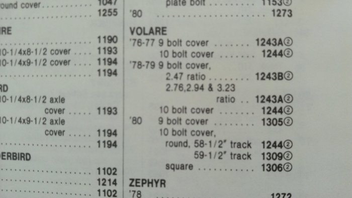

Ok, I haven't fried all my brain cells, it appears there were 2 different widths (track widths) a 58 1/2 & a 59 1/2 this is taken from a Hollander interchange manual.
