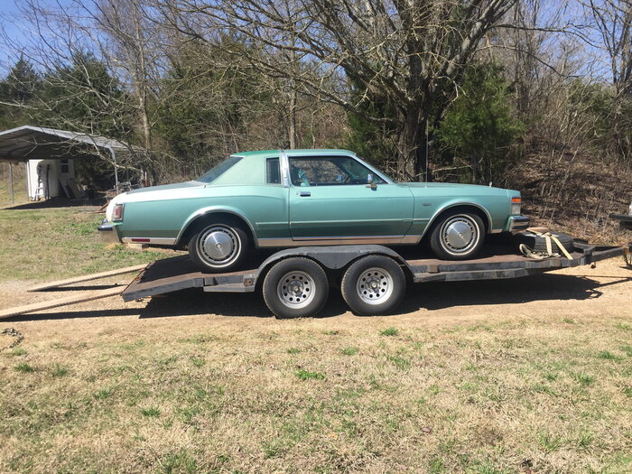

My husband gave the okay for the 79 LeBaron that Tim was selling so...
Here it is:
I have a few things to fix and will put each in its own thread.
I did set up a member photo garage so you can check out all the photos I excitedly took the first few days.
Bwa ha ha ha ha ha!
In general, its in good shape. About double the miles as my 5th avenue. But I love the way the transmission shifts in this car.
It does not have major rust.
It has decent interior (seats are cloth and are getting a little thin).
Thank goodness the door moulding is in good shape -- much quieter than my truck.
It starts and runs really well.
Things I need to address:
1. Driver side door doesnt work with the key. Cylinder just spins.
2. Steering wheel has cracks on both sides. Unfortunately Jim (Arizona) doesn't have one.
3. Leak in the exhaust system. I sound like the guys did in high school that ran everything loud trying to compensate for small weiners. At least that's what the girls thought, in high school.
4. Oil is all over the carb and engine. Looks like its coming from the valve covers.
5. Guy that picked it up says the suspension 'rubber's are all cracked and dried out.
6. Needs a paint job.
7. Spare is the original bias tire. Now why would I drive around with a 40+ year old tire on a car?
8. Electrical wire in the trunk is bare metal connection. Looks like they used a wing-nut that has since been lost.
9. Rear lights have been siliconed onto the body-poorly.
10. passenger side, side marker light has a busted lens. Replacement was in the trunk.
11. Vinyl roof is starting to die.

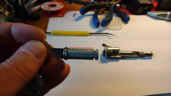

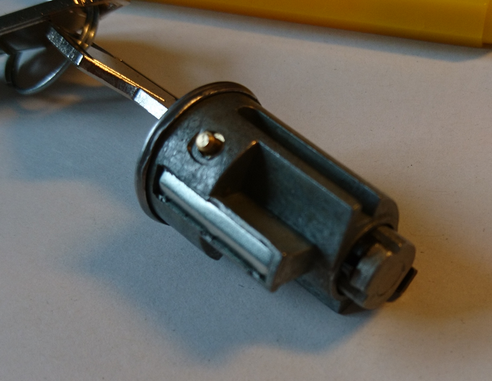

Re the key lock - years ago I re-keyed the ignition lock to match my door keys in my charger (69). There it was easy to remove the ignition lock, rather than ripping the door panels off.. .. I'll try to find some pics of that tedious job.
69-
Dec 13, 2020
454
319
Germany

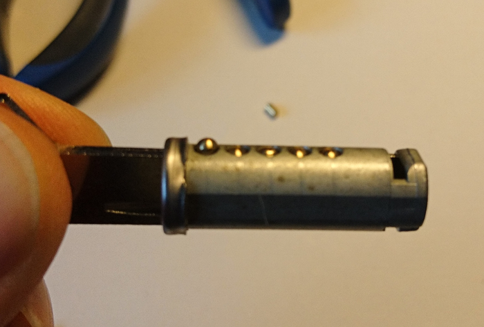

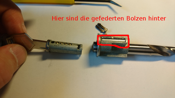

Ah, here they are.That's the ignition lock.

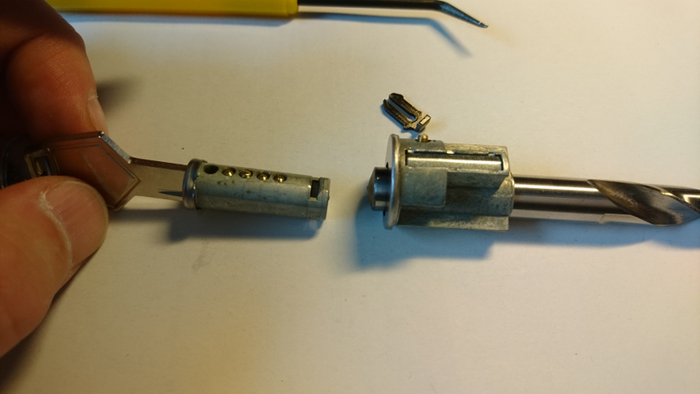

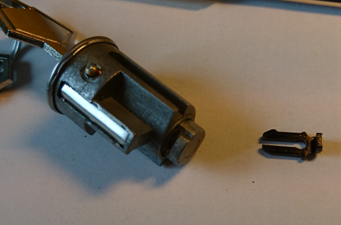

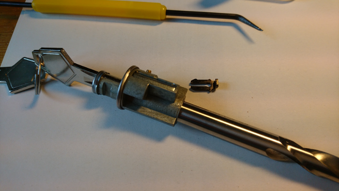

Remove the rear retainer - be aware, that the core slips right out of the shell part, when the retainer is off. Don't turn it upside down without holding the core. YOU WILL LOOSE PINS & SPRINGS!
Take a fitting drill to avoid searching for tiny little pins and springs.... while removing the inner part with the key in.
There you go:

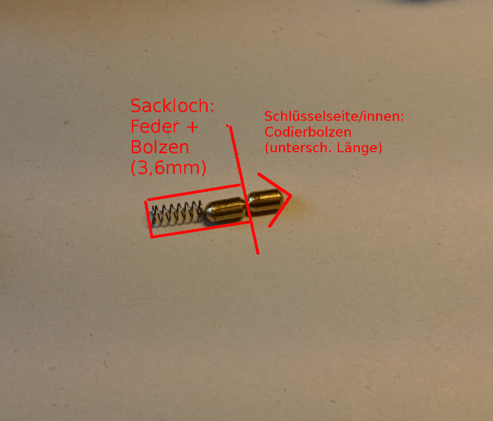

Behind the red marked plate are the springs and pins in various length (to fit the key); that's what it reads on the picture:
And it has to fit straight on both sides - the core (with key in) together with the pin+spring in the shell part.
This is how it works. The spring is inside the blind hole (resulting from the covering plate), then the "shell pin" and finally the "core pin".
All that must mate with the key in to have a straight line. (More or less what it says in German).
This won't work:

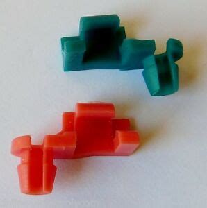

If I understand what you are describing for the driver's door lock, my guess is the linkage rod is not longer attached to the back of the lock. If so, my second guess is the rod was held in place with a plastic retainer clip.

I do see the occasional door latch that fails, as well as the colored lock rod clips that break and so forth - but usually the latch lube causes most issues.
