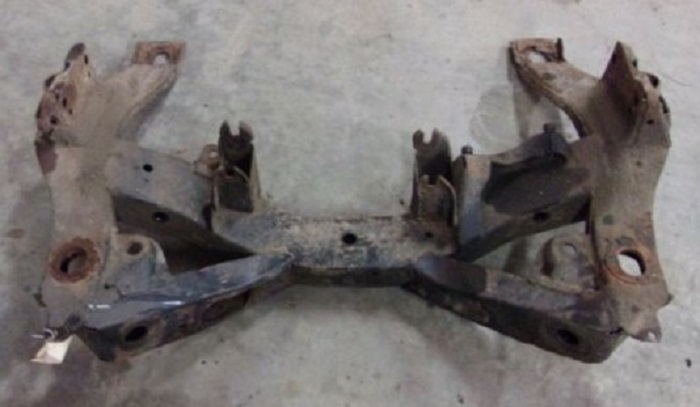

The '66ish to early '73 B-bodies (and E-body) used a normal looking K-frame (worms eye view):

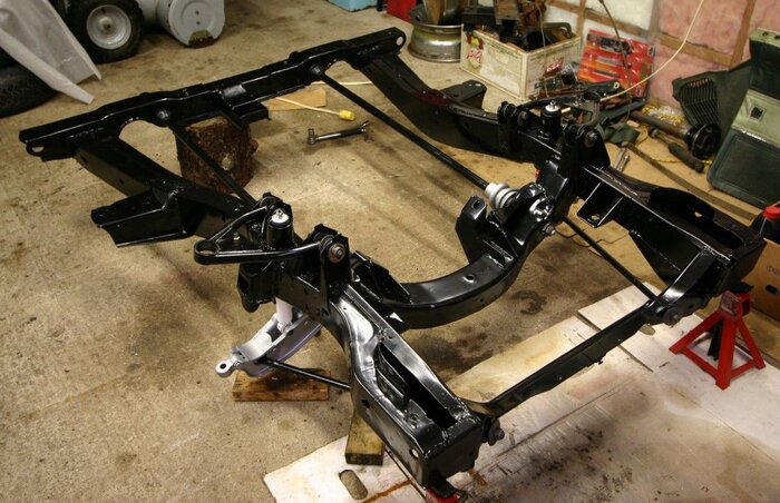

The late '73 B/R-bodies used this design (and also used the same front K-frame rubber mounts that FMJ's use).
Note: this looks more like a X-frame and is heavy. It takes two good sized guys to pick this thing up.

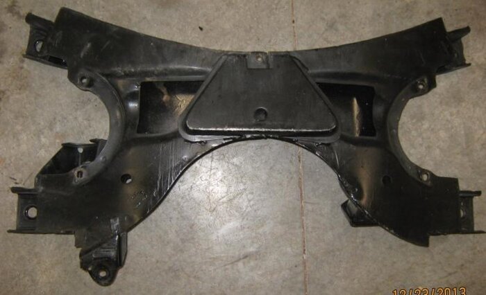

For comparison, this is a C-body K/Sub-frame:
There is enough metal in this to make a new car.

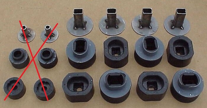

K Member Supports | X-Parts X427-1473-S
The red X is for the separate transmission frame. I "think" the '73-74 used slightly different mounts (same for all 4 corners, I think) so don't think but two will fit our cars - but it makes me wonder...
Nope, solid (iron, aluminum or urethane) is the only way to go!

that actually answered something for me. I was looking into solid aluminum mounts for my buddy's 79 st regis. I contacted firm feel and they couldn't give me a definitive answer on whether or not the b body frame mounts would work on his car. But you (budW) explaining that the fronts are the same as ours gives me a little more info. Thanks. My only other question is are the rear mounts the same?
1,492
The later B-body and all R-body uses the same K-frame mounts as FMJ's use, but in the reverse order (FMJ fronts = B/R rear, and vice versa). The late '73 and '74 B-body uses one pair of mounts but not the other pair (same for each corner).
The transmission mounts are different - but that doesn't affect handling like the K-frame mounts do.
