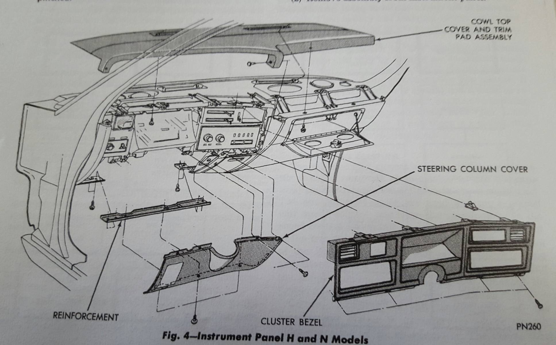

I'll check my manual but i think you need to pull the dash pad and maybe the glove box. The dash speaker is a 4x10. There's new full range versions available. I have the site bookmarked somewhere. Not if a 6x9 will go without some mods. As far as rims go.... I have a set of stock Chrysler 15's on my 80 Volare and they fit just fine. They came off my Fifth Ave.
I'll dig out my manual and post a pic of the dash/speaker setup.
10,745
1,205
The manual says to just remove the pad and cowl to get to the speaker. Looks to be top mounted which makes it easier.

I really like the way 15's fill the wheel well .. looks like the cowl comes out in 1 piece? .. thought 2 pieces when I was there .. I guess I was doing it right, just didn't go through with it. Thanks Captain .. much clearer than the Haynes with multiple models. btw that's a sweet ride you got.

If you haven't gotten it apart already, it's just the bolts above the cluster, a couple above the glove box and the 2 in each defroster vent and the top slides right out.
Some engineer screwed up and made it come apart WAY too easy! lol
10,745
1,205
They'd never allow that now.

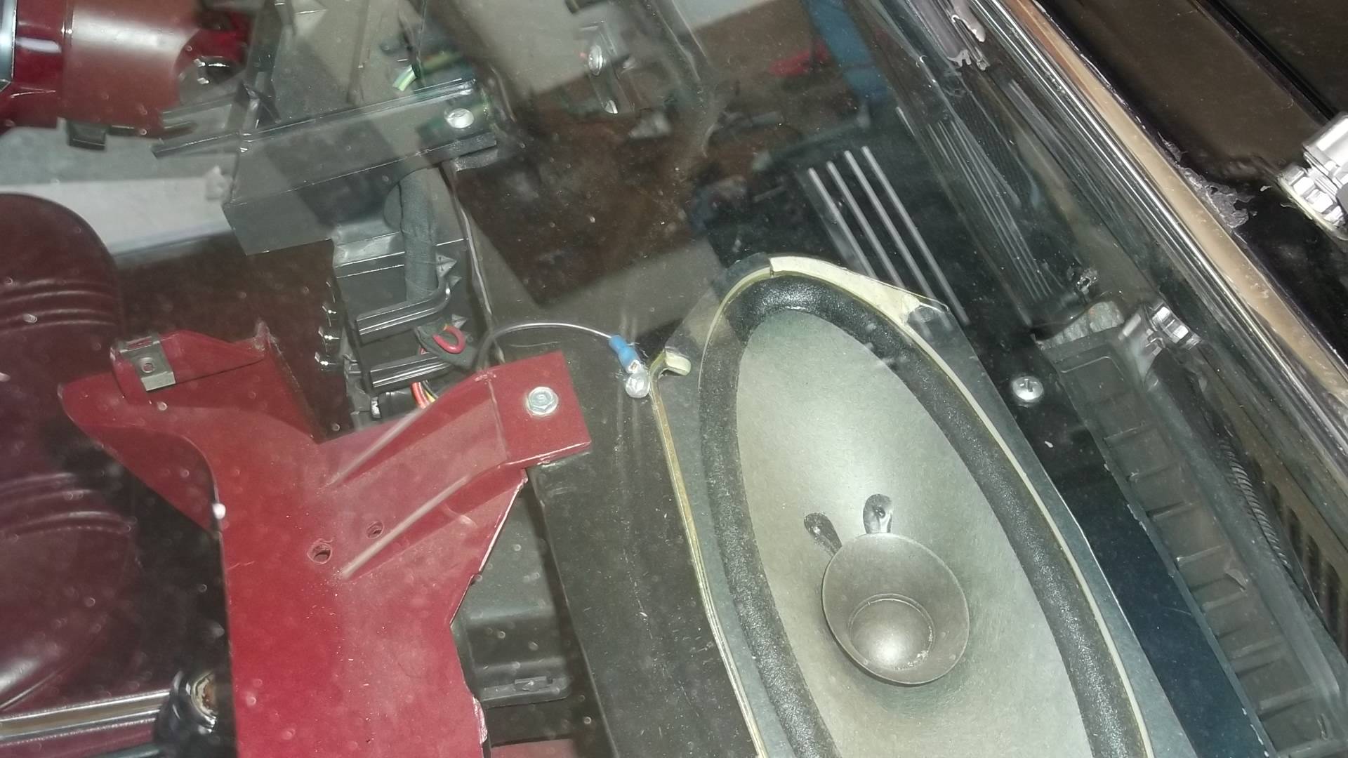

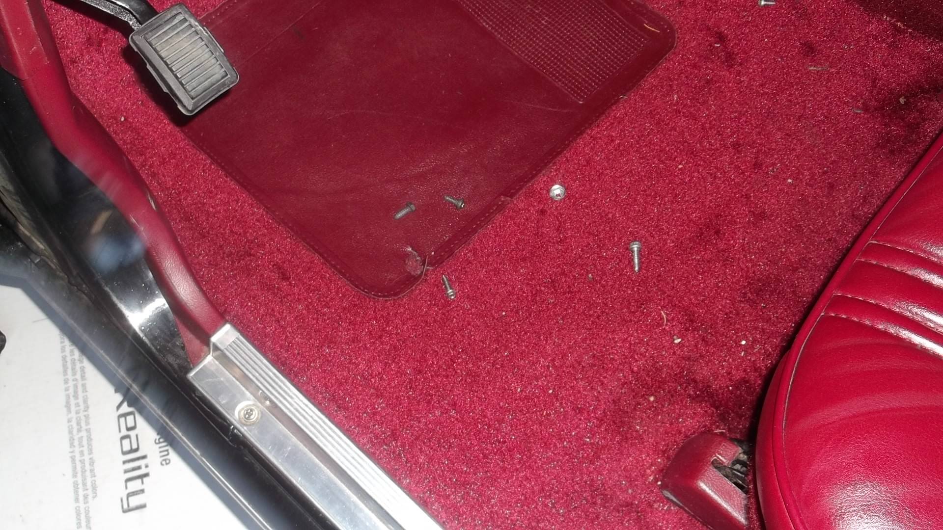

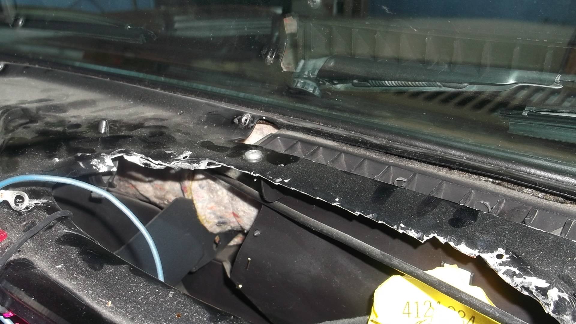

Well guys .. I don't know how to say this .. I feel violated .. I wasn't the 1st getting into the Volare ?? and what a mess to straighten out ... mismatched bolts and screws grrrr... I got everything back to 5/16 and proper screws .. the next time will be easier
what's that grd. screw for ??
hacked
obligatory spare parts pic. ...lol
I deleted the front rattler of a speaker and will just keep the rear speaker box .. also tho it looked stock the radio may not be .. might upgrade to a digital tuner .. in the future ... enough for now
