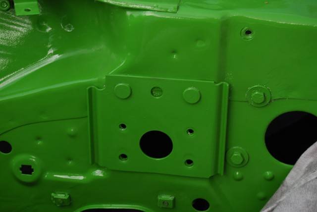

:happy3: Manual brakes are the way to go
