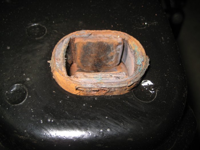

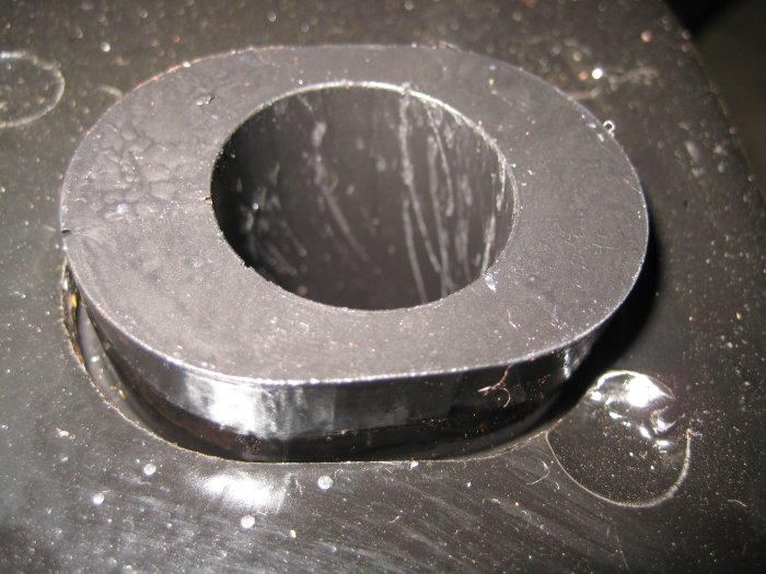

The challenge (problem?), I have is twofold. One is the fit of the 'insert' section of the isolator that goes through the hole in the K frame. The factory isolator has a metal band around that section so it is a tight fit in the K frame hole. However, the ESPO item has a gap of ~0.5mm between the insert and the hole in the K frame. To me it should be tight to prevent and potential movement. The factory torque specification for the through bolt is 80 lb. ft. which, to me, would not be enough to 'crush' or 'spread' the isolator to prevent any movement. Pictures below; first image shows the lower front polyurethane isolator in place (notice the gap), the second image is original lower front isolator in place.

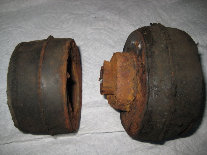

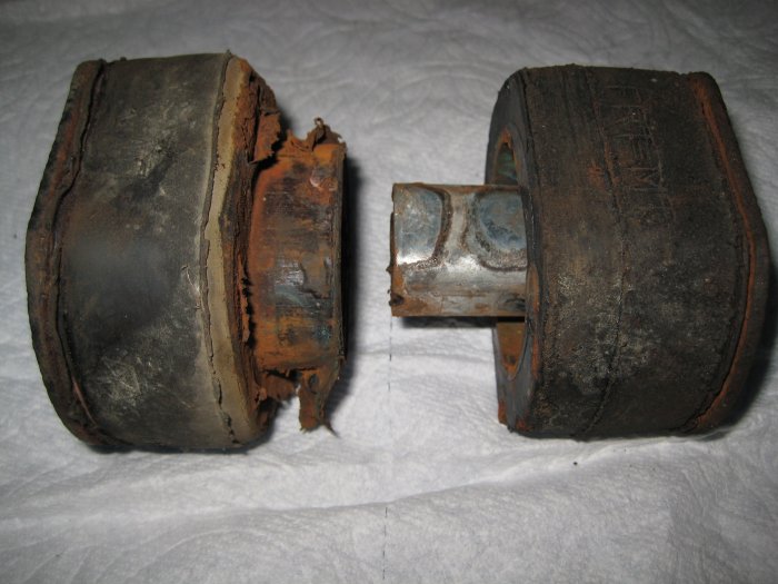

The second concern is the orientation of the isolators. From the factory the front isolator has the insert piece as part of the lower isolator and the rear has it in the upper isolator. The factory must have done this for a reason??? Pictures below; the third image shows the original front with the upper isolator on the left, the fourth image shows the original rear with the upper isolator on the left.

This won't necessairly give you all the details you're looking for...but way back when I used the POLY pucks (don't remember where I got them from, could have been Springs'n'Things though).
The package I got had these large thick washers that were to be placed against the K-frame (at the top) and at the bottom they were used for the big bolt to press against as it 'captured' the poly puck.
OK, so take a look at the photo that shows the PASS side install. You can roughtly see how they came together.
You are right, they certainly were not spot-on, there was movemement. I also glued the washer onto the POLY puck first so as to move positively locate that thing and worry less about stuff moving around on me as I proceeded to assemble the whole thing.
With 80 ft-lbs of torque those pucks did compress!

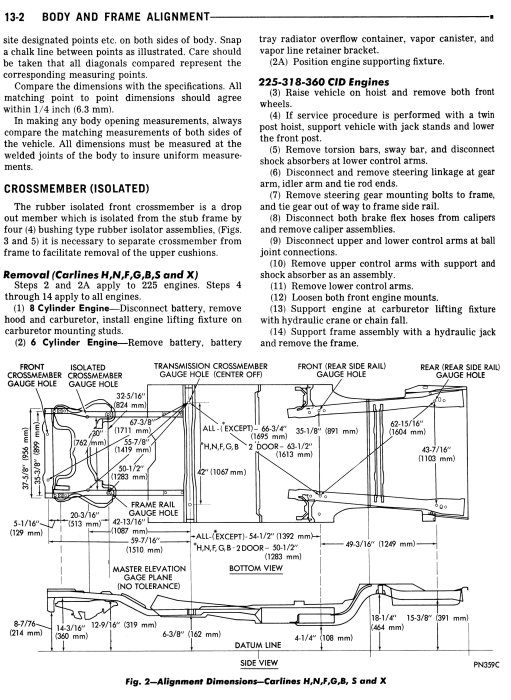

1) I am sure your '88 FSM has the same chart, but here is the scan out of my '80 FSM book, for the 2dr. crowd this will help
Specifically I would use the 'TRANSMISSION CROSSMEMBER GAUGE HOLE' to 'ISOLATED CROSSMEMBER GAUGE HOLE' measurement, which is 55-7/8" (1419mm) on my chart.
That would pretty much take care of the K-Frame to chassis alignment in all four directions (front/back & left/right).

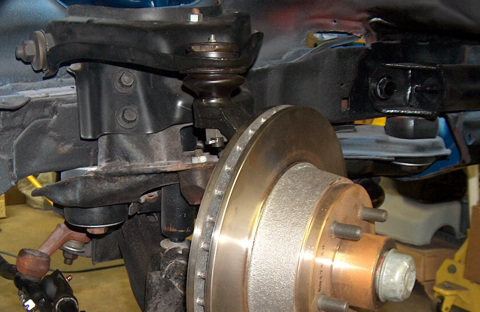

2) Rotors...my man, it's been forever that that photo was actually taken (2005 is what the image EXIF tells me LOL). My parts tracker though say I have:
#5311, QBS, 11.75" HD rotor (which crosses to Raybestos 7038)
Yup, when you could still find these goodies on eBay for like $40/set...lol, I see a bunch listed now, but that's normally a $90/ea expense these days.
RockAuto shows them at $47 right now, find a 10% discount coupon and that's a much better price!

As always, appreciate the info. I checked my FSM and I have the same diagram. My diagram references the same 'transmission cross member gauge hole' for the 3 reference measurements. I'll keep the rotors in mind, the ones on my '88 are original and in surprisingly good condition.
