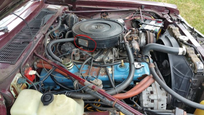

The more I think on this, the more I think the sensor is moot...I seem to recall that the original air cleaner housing for the 1 bbl had a square cutout in it that was blocked off with a homemade plate of sorts....would have to dig it out....thinking that was where the lean burn may have been, and removed by the previous owner.
If that is the case then the sensor wouldnt do anything but take up room in the engine bay......because without the LBC, its just a typical old mopar spark box and ballast running stuff.
But I thought the hole in the air cleaner for the LBC was a lot bigger than what we had on ours.....attached a picture

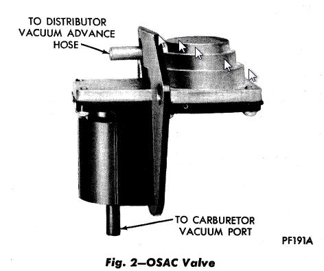

The item circled (above) is a block-off plate for cars without OSAC valve (which looks like part below). All it does reduces the rate of vacuum change to distributer vacuum advance – to reduce NOx emissions. Most people bypass it for better drivability (in states that allow that).
That block-off plate is hard to find and I’m sure someone would be willing to take it off your hands – if you elected to sell it . . .
