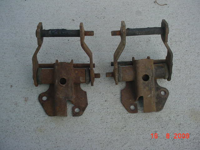

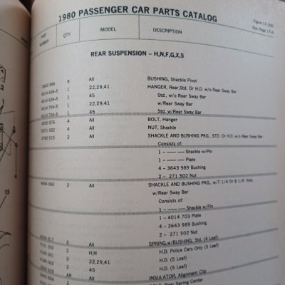

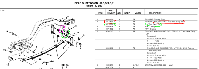

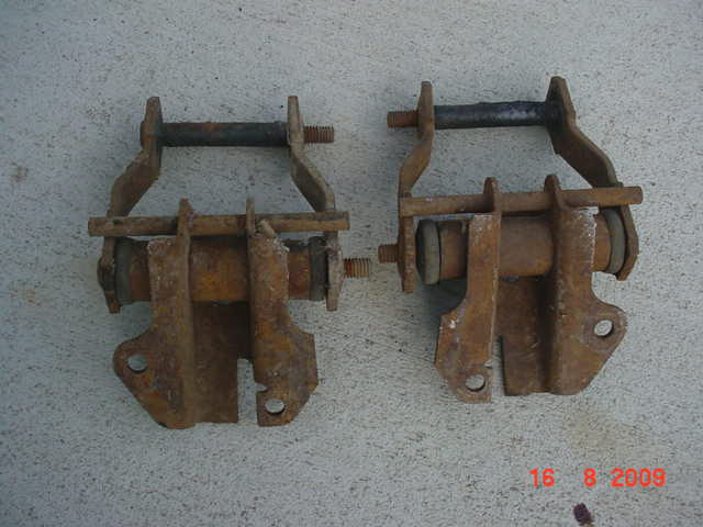

I'm trying to decipher my '80, '81 and '82 parts book information to determine which were the valid combinations of HD/FLEET wide rear shackle frame mounts AND sway bar installation.
As best as I can tell it would appear that you could NOT order a rear sway bar if you ordered the HD/FLEET (aka. wide shackle) mount...but that almost does not make sense...or is that just me??? LOL...I mean we all have shopped the yards for the police vehicles which typically had the sway bar and the wide shackle mounts...yeah?

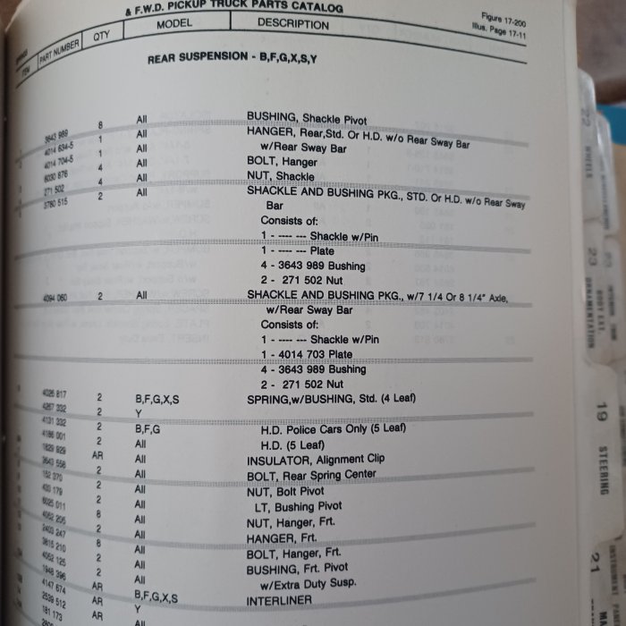

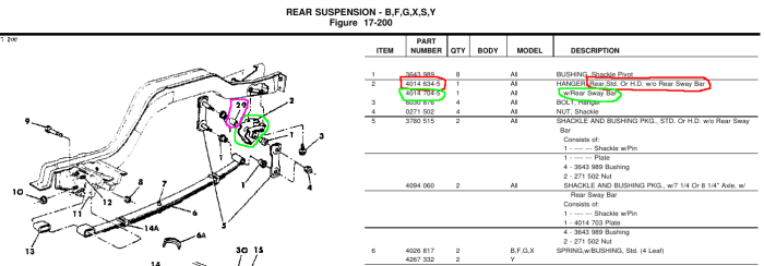

Take a look at the attachd '82 book scan:
1) RED - 4014634/5 - Std or HD w/o sway bar
2) GREEN - 4014704/5 - w/ sway bar
...and perhaps the key to this is part# 29 in that pic (pink), which is some kind of a bushing/tube which the parts book calls "INSERT, w/Rear Sway Bar".
Sooo...I would understand if GREEN was simply the RED with the added #29 INSERT...but what I'm still not getting is that the wider shackle frame mount (which I always thought only came on HD/FLEET suspensions) doesn't appear to be different from the Standard setup...so what gives?
Was this available on certain model years only?
