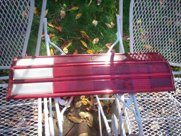

OK. I have all kinds of tail lenses that are sun beat and spider cracked through the red and amber (78 only). So starting with the worse set I cleaned them as best I could and rubber cemented the parts that started to split. Now since my car is a 79 and it does not have the bulb for the amber, it means less taping off. I used blue painters' tape to cover the clear lenses (reverse light).
I picked up this stuff called "Night Shades" in red "see through" paint. They make night shades in black for tinting tail lenses and other light lenses.

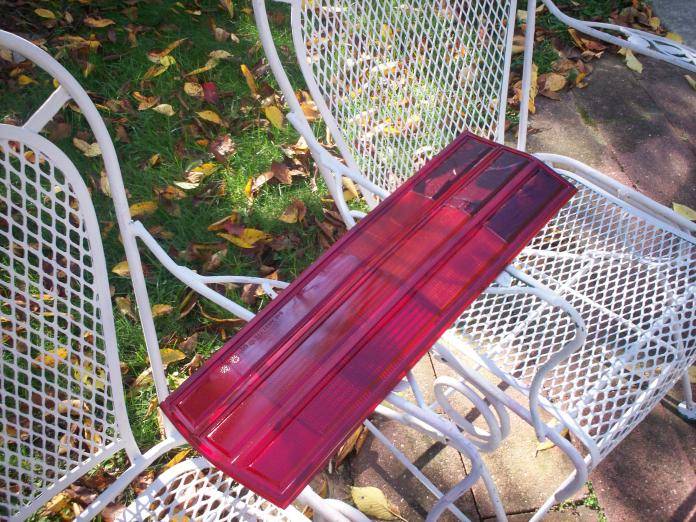

So now I've done a few more lenses that were destined for the trash heap. So If you have red lenses that are really bad or want custom, but are not sure- try that as a fix. I'll post a pic on this latest set after they dry tomorrow
Now that one is still only one coat and the other was done last year to avoid the trash can and is one coat as well
No Capt, that is sprayed on the outside surface. I only lightly sanded, but the weathered plastic soaks the paint up. It still has the blue painter's tape on it.
