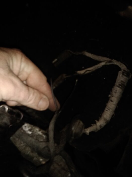

Awhile ago I had to replace the entire taillight wiring harness with the Fifth Avenue's, the one thing I wasn't sure of was/is what do I do with the license plate light wiring which as you can see has plugs for two sets of lights and The Cherry Bomb only has one set. Do I splice the wires to one plug or both? IMG_2023-04-08-23-12-21-740.jpg

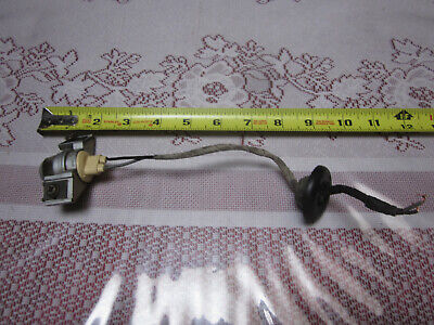

I stole this image from Ebay of a single plate light. If you just need 1 light, just give that 1 light power and ground. So if you have 2 powers and 2 grounds, just use one set and just heat shrink wrap the other (obviously not touching the hot and ground together) and tuck it away. Never know when it might come in handy later.
