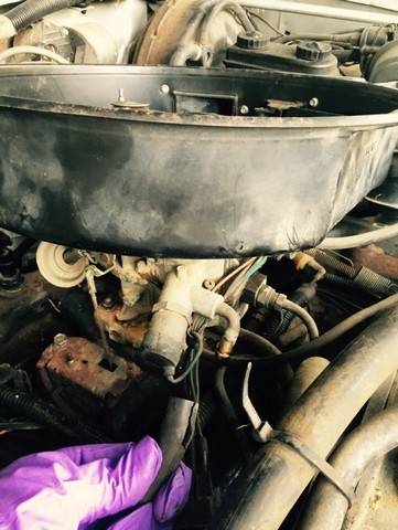

Tonight, I chose to follow the lines from the round black cylinder thats near the front passenger side of the grill (canister?). One line winds around to the back side of the carb and I feel around there making sure everything seems like it is tight and fully seated.
One line comes to the front side of the carb and here is a picture:
The hose I am holding obviously has a cracked end. That part was on the bottom side so this is twisted so you can see the crack. This hose goes on that shiny copper outlet just above it.
Seems important that this be replaced. What is it and what problems does it cause because it is cracked?

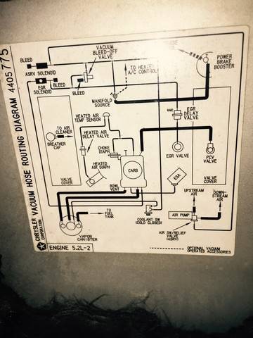

There should be a sticker on the hood I believe that shows all the hose routing. If it's not there I'm sure I have one in my FSM. If you need it I can post it.
I think I'm looking at something from the vapor canistor going to either 1) bowl vent or 2) carb
The diagram just show a big rectangle with a circle in it for the carb.
I'm currently checking the pages in my service manual but without an index, I'm still at the flip through all the pages til I find it stage. Still learning what these devices are called and whether its considered part of the engine or part of the carb , etc.

Alright, I finally found it under emission control system, not carb, not fuel system.
So basically I should replace that hose from the canister to the vent bowl (for sure since its cracked).
Then in chapter 25 - Emission Control Systems I should follow along all the recommended checks for tests in that chapter.
That large line is going from carburetor vent solenoid to charcoal canister. What it does is sends fuel vapors to the charcoal canister (which stores the fuel vapor from carburetor and fuel tank).
If you notice there are four hoses going to the charcoal canister.
Two are "vapor in" hoses: from the torn hose shown above and from fuel tank.
One hose leads to base of carburetor to burn off the above mentioned fuel vapors.
The small hose is the on/off switch to allow those vapors to get burned off.
Depending on what state you live in and if your car has to be emissions certified, fixing that hose may or might not be important.
The car will not run better or worse with the hose fixed. Fuel mileage will be a teensy bit better, for your engine will be burning the fuel vapors instead of allowing them to vent into the atmosphere.
The hose is not under pressure, so use whatever hose you find will work. You most likely will also need to replace the short piece of hose by canister that the same plastic pipe also attaches to.

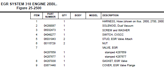

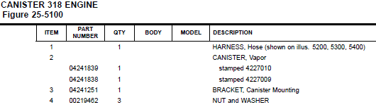

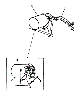

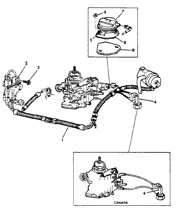

Yes and no.
Chrysler used odd size hoses for vacuum, P/S and the like, so sometimes finding the correct size can be fun.
I will attach copies of what I have, later today.
--- Post updated ---
Anytime I purchase hose, I purchase 5 or 10 feet of it and keep the remaining amount in a 16” x 24” x 14” tall clear plastic bin. That said, I go through hose maybe more so and most people do, for I have a personal fleet of vehicles to keep running.
In your case, I would take samples of your hose(s) to parts store, after you guessimate how much is needed. Then purchase about 50% more than you need (for mis-cuts and other things that happen).
I really dislike making another run to parts store over not getting enough of what I originally went to get.
Note: Most (if not all) of the part numbers listed, have long been discontinued.

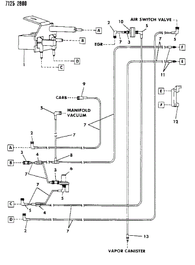

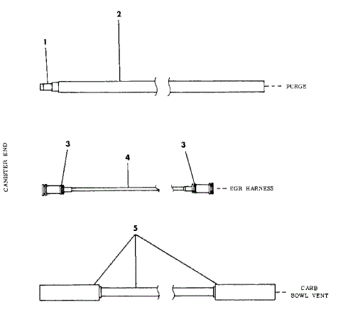

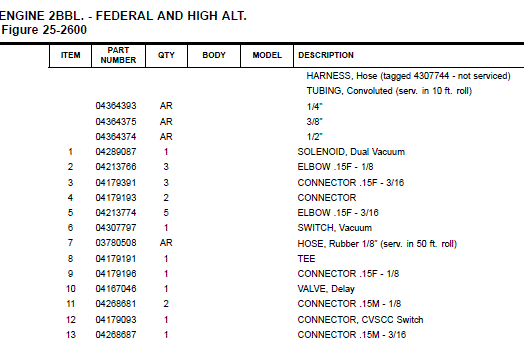

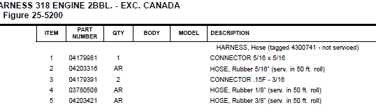

Wonderful.... exactly what I was looking for.
So I think I need 5/16, 1/8 and 3/8 hoses in diameter and just however long my pocket book can handle.
