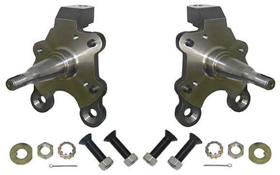

There is (or was, at one time) new aftermarket steering knuckles/spindles that gave a 2 inch drop. They require special steering arm bolts that have a tapered head because normal bolts will not fit.
There are two different "major" versions of the above part. The A, E and older B-body (the above picture) and the FMJ, R and newer B-body version - which the upper ball joint flange is about 1 inch higher. Both versions look the same at first glance but when sitting side by side, you can tell the FMJ, R and newer B-body version is taller.
Both versions "can" interchange but the geometry is slightly different as suspension travels up/down.
