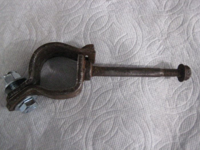

The passenger side front sway bar mounting bracket was rusted more than expected as a result, the threaded rod snapped just below the nut. :-( I have managed to affect a repair of sorts by cutting a thread on the remaining stud, doing the same on a 5/16" bolt and using a threaded sleeve (with LocTite), to join the two halves together.
However, I would prefer to replace the bracket and use my 'repaired one' as a spare. So, if you have one or a pair, let me know what you would want for them.

Hello M_Body_Coupe,
The original design appears to have the threaded stud staked in place at the factory. The signs are visible on the inside of the bracket. I believe they did this to ensure the bottom side was smooth because that surface is part of the support for the sway bar bushing. A weld would have required dressing which would result in a more expensive part. See the picture I attached in the first post.
I considered drilling out the old stud and welding in a new one (I have a decent MIG welder), but I was concerned the drilling / welding might weaken the original staked in boss. I'm probably being anal about weakening the stud to bracket joint. :)
If I'm able to get my hands on another one (or two), I'll take my repair (threaded sleeve), apart and experiment with drilling out the remainder of the stud. From there I'll see what options exist to weld in a replacement stud. If it ends up being a viable solution I'll post pictures of the result.

Hello Mikes5thAve,
I don't think the cop ones are welded in - at least I can't find any sign of welding. As mentioned, they are staked in place which could mean they are first pressed in and then staked?
Hello M_Body_Coupe,
I like your idea of a carriage bolt (deck bolt as you call it). I may just try it as an experiment. I don't have any machining capabilities but I do have a very good 1/4" square file. I little elbow grease and I could create the square hole. Having the hole the full length of the boss built into the bracket would allow me to 'fill the gap' with weld.
Need to check with my local fastener supplier to see if they carry Grade 5 as the 'regular' carriage bolts are apparently only Grade 2 (never heard of that level). As you mentioned, the smooth rounded head should have very little affect on the bushing and adds another level of strength to the repair.
Once I have the replacement brackets I'll set aside some time to test your theory. :)
