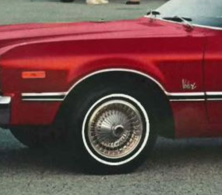

There are two different wire hub caps used on FMJ's. There is a 14” one used mostly on F's, which I will refer to the lightweight version and the 15” one mostly used on M's – or what I refer to the heavyweight version. The later version uses the lock bolt (mainly, to prevent theft).
A "14 wire cap, from a Volare Sales Brochure.
Note, they also made a 14” locking wire cap for front wheel drive cars – which looks similar to the M-body heavyweight design, but won't fit. Well, I guess you could make them fit with 14” wheels, if one really wanted to, maybe.
I know of people who has not used the lock bolt (or an ordinary bolt, as far as that goes) but they are not people who drives the car that hard, either (like I do). Both versions of the wire caps are hard to get on or off – but under extreme usage, I bet I could get one to fly off of the car (if not bolted on, that is).
Note: people was stealing hubcaps (and radios, and …) back in the '70's and '80's, so having locking hubcaps were a real thing.
Today, not so much (unless you have 22” wheels with rubber band tires . . .)
Edit: Most of the M-body's used 15x7" wheels. If one was going to bolt the caps onto a 15x5.5" wheel, you would need to remove the 1" extension from the cap.
