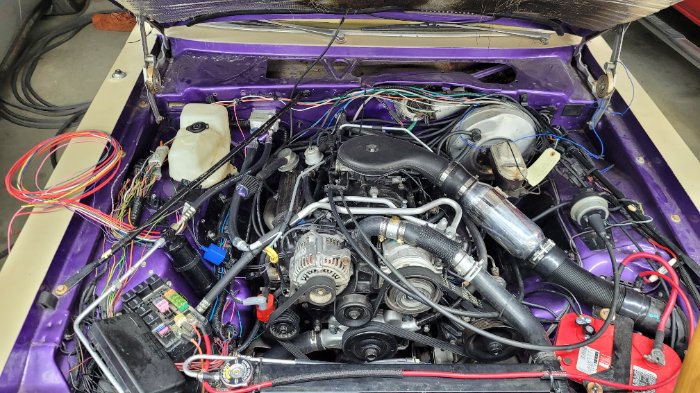

The engine and transmission are stock 1995 ram truck with a few jeep grand cherokee and aftermarket parts for AC and air intake. The stock PCM runs the engine, trans, fuel pump and cruise control. The evap canister and related were moved from the truck as well. The truck PDC was transferred to power variatious electrical equipment.
The radiator is cooled by an electric fan from Derale.

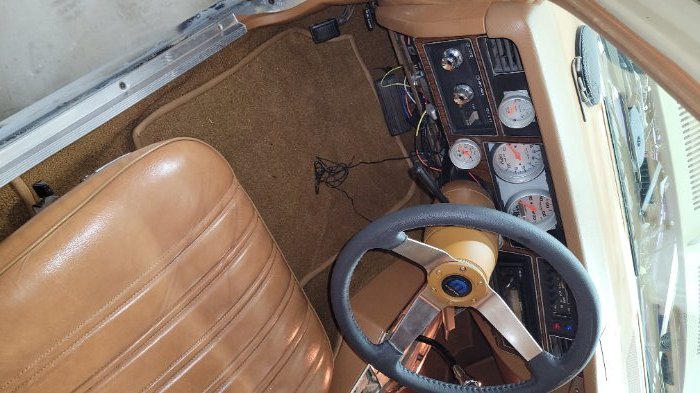

The gauges are autometer on a custom mount in the dash. The MIL lamp is in the gauge mount and is from painless. The speedo is driven by the VSS from the truck.

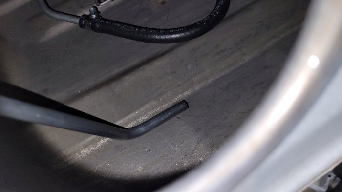

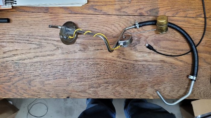

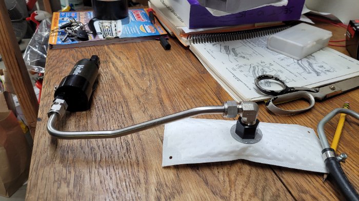

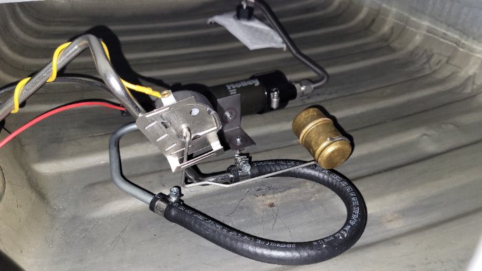

The fuel pump is a custom creation by myself based on a blog from Holley about how to make a custom in tank fuel pump. I used some hydra mat, a submersible pump, stainless tubing, immersion rated fuel hose and a replacement sender. It is powered via the Truck PDC and fuel pump relay. The fuel filter and pressure regulator is from a late model corvette, which is commonly used for LS transplants. The return goes into the bottom of the tank via a dedicated bulkhead fitting; the line is visible in one of the pictures. I used the stock tank.
