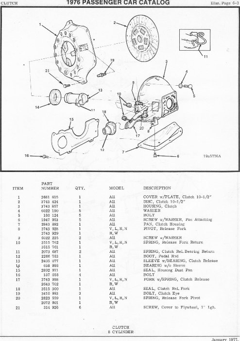

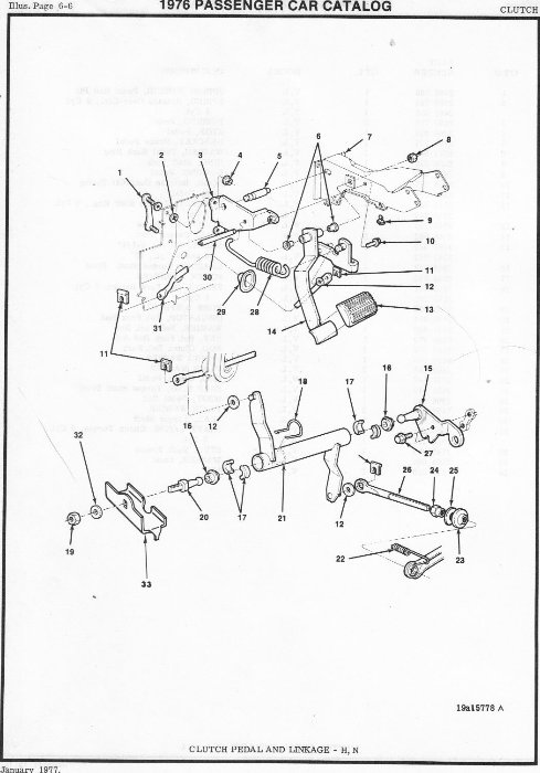

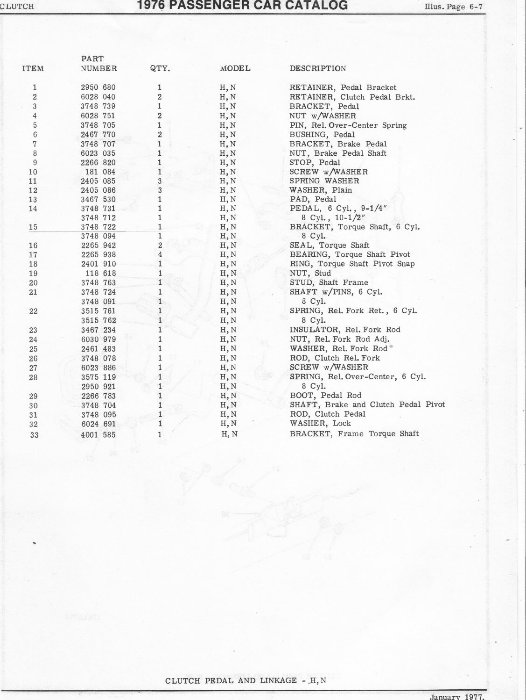

Someone else here will know more about manual swaps. I do know that you'll need the A body manual tunnel hump: Four Speed Shifter Tunnel - 67-74 Dodge Plymouth A-Body
and you'll need the F body clutch pedals:
There's more to it, but I haven't done it so I'm not an expert. You can probably find this stuff cheaper if you're not in a rush.
