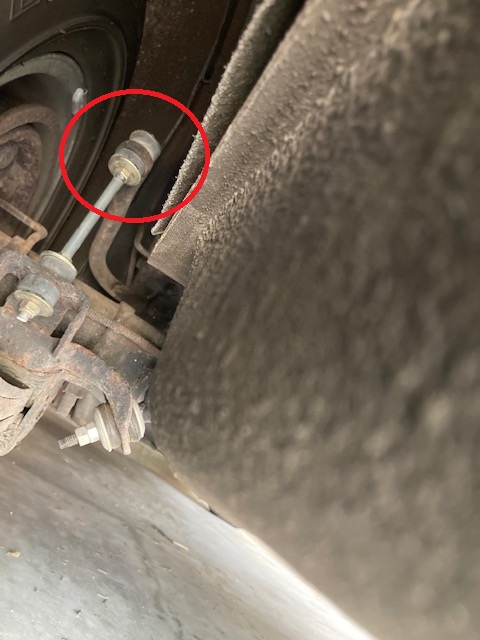

My Mirada Rear Sway Bar Link snapped and I can't find a replacement anywhere, anyone have an idea if there is one from another model that fits?

Any universal aftermarket one will work you just have to measure the length of it to figure out which one. I don't know what part number the ones I bought were but they were readily availalbe.

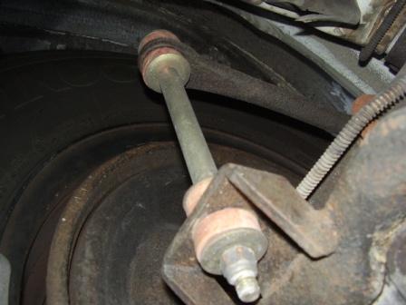

Here's mine. Been on the car awhile now. Very beefy replacement and the kit was not very expensive. I would've preferred the black urethane bushings but they were all out.

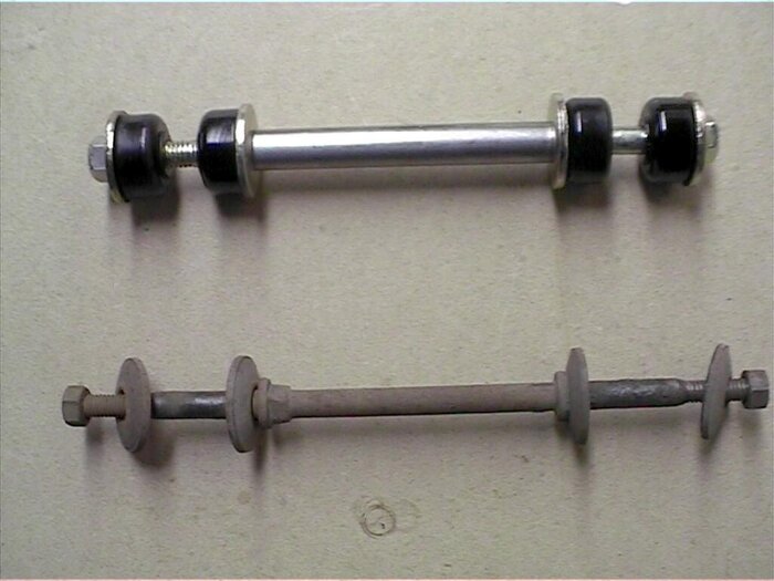

I've had awesome experience over the years with folks at Springs'n'Things (Quality Automotive Suspension Parts For Your Classic Car or Truck). My only complaint today is that what used to be a nice and easily searchable catalog has somehow gone away...at least here on my end I no longer find it, instead it's all nearly an emal/phone call back and forth.
The set I picked up for my coupe years ago was a Grade8 bolt with poly bushings. The steel sleeve is what separates out the bushing ends from each other, it's length is what defines how close or further apart the sway bar link is to the ISO pad plate. Normally just go with the stock measurement. If your ride height changes you could go with a longer sleeve (and matching bolt of course) to maintain a 90 deg angle at normal ride height.
I've attached the compare of the aftermarket and stock setups.
