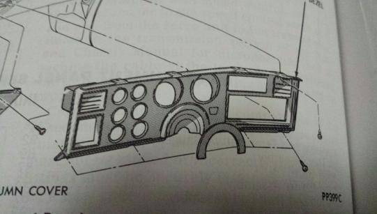

Stupid question... I've got to get to my dash speakers and forget how I got the dash apart to install them. Is there a tutorial or anywhere that could steer me in the right direction?
I don't know of one on here.
When I get around to doing my speakers I'm going to post one.
I'm guessing J bodies are pretty much identical to F's and M's.
Basically the gauge cluster bezel comes off first. If you follow it around you'll see four screws along the top and four along the bottom (two on each side of the steering column. Take those out and tilt the top of the bezel towards you a and wiggle it up and out. If it's a column shift it's muck easier if you drop the shifter down to 1st.
Then if you look where your defroster vents are you'll see there's two hex head screws on each of them. Once you take those out I think the whole dash comes out.
If memory serves I believe you have to take out the glove box (or just unscrew it and it'll come out with the dash) to get to the right speaker and the top left gauge cluster (alt/temp)to get to the left one. Again I haven't done that part yet.
Be careful with the bezel and such. Remember this is very old brittle plastic. If you excersise patience you should be fine.

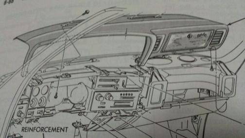

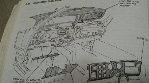

Here's the best diagrams I could dig up.
J bodies are different, the dash pad is part of the dash structure. There is a cover on top of the dash that hides the speakers and the mounting bolts for the dash.

It's that easy! I do it all the time... Just put a flat blade screwdriver between the dash pad (the soft / top / front part of the dash), and gently pry up the top plastic piece. It'll pop out at one corner, then you just grab it and lift it off. It's held on by about 6 friction-fit springs. To replace, you just line up the springs, and tap it back into place.

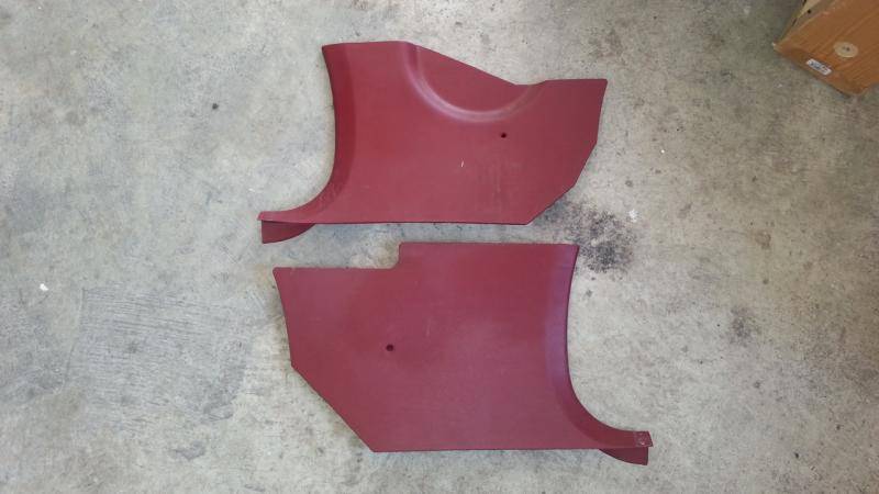

Yeah no tint and such means hiding it is the best course of action. Hence the factory HU staying and being the dummy. Plus i hate modern radios in old cars. Since i need a modern HU to do crossover duty, its my best approach. I am going to try to source a pair of these interior panels and modify them to be kick panels with a 6" driver in a custom pod. That way they'll fit right into the stock location and be colour matched. That way the stock ones are left in tact should I choose to to back and the speakers will be fitted to look factoryish. Or at least not stick out too much. Anyone know the odds of finding a spare set of these cheap? Otherwise its an all fibreglass custom jobbie.
