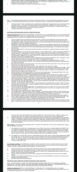

I'm sorry, I had no intention of highjacking the thread.
Anyways hopefully this photo is legible. This is the exact instruction sheet that I was given with my kit. I just followed it to the letter. I know the car did not come originally equipped with an external ballast. Instruction sheet does not have a section that mentions anything to do with the ballast not originally being equipped. And again it's for full removal of the LB, not running in tandem with. First time doing this type of install.

No problem! My car is fixed, so at this point we’re just discussing and maybe can hash out a potential issue with your car, or help out someone else in the future with similar issues.
Unfortunately, I really can’t read that instruction sheet because the picture is too grainy. Can you post it a different way?
I’m confused on how you wired up a ballast resistor with the factory key switch. What year model is your car? The ‘89 that I was working on does not have two separate start and run circuits in the key switch. The start and run feed 12V to the coil from the same source. (EDIT due to poor choice of words: since we have been only discussing ignition coils I made a misleading statement. Of COURSE the ignition key switch has a start circuit, and a run circuit, which are both independent and have separate responsibilities. I recall from the wiring schematics that the start circuit, and the run circuit, both feed the coil 12V through the same 14 ga dark blue wire. No provisions in the factory wire harness for a firewall mounted ballast.) It would be unnecessarily complicated to add a ballast with that factory key switch and wiring. I never looked into that because there was no purpose in using a ballast on the ‘89. The factory coil and ICM for that car will withstand full voltage while the engine is running so a ballast is only going to limit the ignition power potential.
Does a ballast resistor make a noticeable difference in power output on a bone stock low compression smogged out LA 318 engine from ‘89? That I do not know for sure

That's the best picture I have I'm afraid.
I would have to look over it, maybe upload a picture for you of the actual install. But I'm not with the car right now.
The only wiring I remember is tapping into the dark blue wire at the bulkhead connector, running it across the bay. After that it's all foggy lol
Mine is the same year, an '89
I can't do any testing right now, timing cover and WP are off.
I will post the link to the kit:
Electronic Ignition Conversion Kit, Hi-Po ECU
If you click on "view this products spec sheet" it downloads the install sheet. Then open it and go down to the "replacing lean burn" section

That link worked for me, and I just read through it. Come to find out, their instructions are 95% excerpts pulled out of a Mopar Performance small block book. The way I read it, they’re not instructing on how to fully disable/remove the LB/SCC, but rather just how to install the traditional electronic ignition and disable the internal ignition module inside of the SCC. The instructions seem somewhat generalized and probably aimed more towards the older cars, but ours really are not that much different.
For the ‘89 I was working on, the computer box contains an internal ignition module, controls spark advance, receives input from the distributor pickup and a detonation sensor, controls fuel metering inside of a Holley 6280 carb with feedback from an O2 sensor, the EGR solenoid, the air pump solenoid, idle speed kick up solenoid, and I’m sure I’m forgetting something else. Does your car have a feedback Holley 6280 or a non feedback Holley 2280?
My goal with the car I was working on was to fix the troubled ignition system. The car belongs to a close family member and is not a performance car, but just a car to putt around in. I didn’t want this family member to have any issues with state inspections, so I only needed to make the ignition system reliable again. What I did was really simple and the computer is still doing everything the same as before, except now the ignition module is external rather than internal in the SCC.
