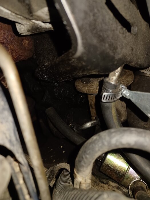

Yeah, I'm not looking forward to this. Car runs fine, but I smelled gas and sure enough there's fuel coming out at the pump at the flange where the top and bottom halves of the pump meet. So it looks like whatever seal is there just put in its resignation. God only knows how old that pump is. I wouldn't think it's original but who knows

Well after looking at it in the light, this makes a lot more sense. Get a load of how the previous owner plumbed the fuel line
I'll admit I put that fuel filter on, I replaced the one that was there with this shiny Mopar one. I should have spent more time looking to see what was attached to it. Why couldn't the previous owners of this car do anything right? It's like they had a perfectly good car and instead of repairing it they just made it worse.

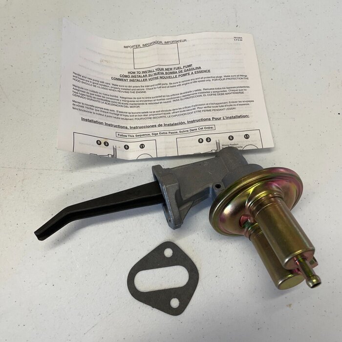

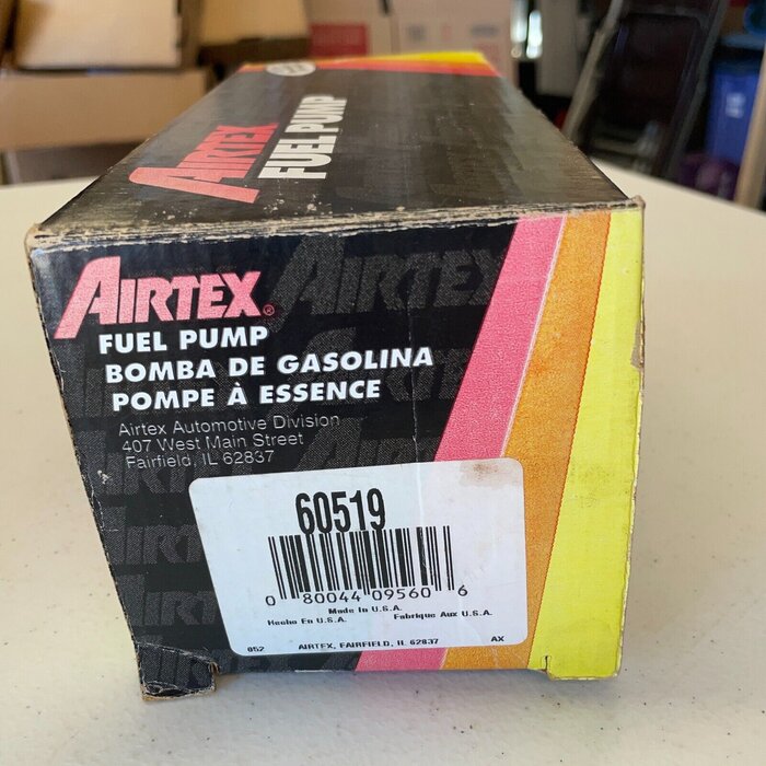

If I had to do it again, I'd get the horizontal mounted hose barb. I got a great deal on an Airtex fuel pump 60519 with the barb pointed down. It's listed as the correct pump and was $18.48 with tax an shipping. Pretty cheap. I think these were an old school Autozone brand. A horizontal barb would have made the supply hose routing easier.

Airtex is a major auto parts supplier. Most of their stuff is pretty good, or was, I've had good luck with their products in the past
I bought it because it said "Made In U.S.A." on the box and the seller made me a ridiculous offer. Car fired off the first time I tried it. Old pump was leaking and I found the arm was loose once I got it out
