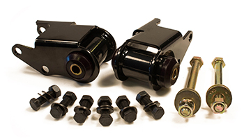

Schumacher makes real nice mounts: '73 & UP A,B,F,M, J-Body Products
I ran them on a 360 for years. If you don't want to spend $160 on mounts though then as said, you can make the driver's 318 mount work by shimming it with washers.
