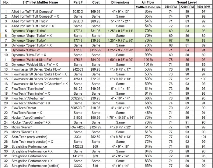

I'm running Doug's 453 headers, into an X pipe with Dynomax Super Turbos, all 2.5 inch pipe. I went with the Dynomax after watching a lot of Dyno testing with mufflers.

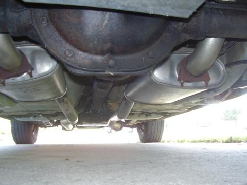

I have Walker Quiet Flows on my stroker 360 with Jegs A body mandrel 2.5" dual exhausts and TTI headers. But then I like quiet (obviously much louder than stock with no Cats and headers). Btw I don't drive it very often and they have really lasted! A slightly newer picture would show my beautiful frame ties custom made by Duke5A!

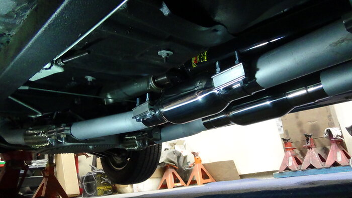

Dual 2 1/2" from the (Schumacher) headers, through a pair of Vibrant Performance bottle style 12" resonators just behind the flex pipes up front, to Dynomax Ultra-Flo welded 14" mufflers, dual 2 1/2 t-pipes out under the bumper on the right side (left pipe goes up, across over axle and then follows the right side t-pipe out). In "normal" driving it sounds good, a little on the loud side though, and on accel it's not going to sneak up on anybody. Actually louder than I'd like but it is what it is.
Used to have the Dynomax Super Turbo's and I loved the way they sounded but the interior resonance was deafening, on my particular car and engine anyways.

I ran 40 series with my 360. I still love the sound, but despite the name they don't flow all that well. There is a chart somewhere on Moparts that shows the differences.
Straight through mufflers with fiberglass packing are the best performance wise.
