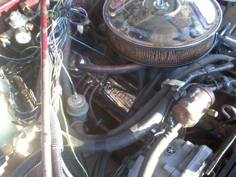

Hi everybody! I've watched and read this forum for years now. Lots of good info and help here and on the other forums for A-bodies, B-bodies, trucks.
My '81 Imperial quit running on it's EFI system over 16 years ago. It is now once again running, licensed and insured. I did my own shadetree conversion.
Edelbrock Performer non-EGR intake, Carter aftermarket ThermoQuad 9801S, Mopar Performance electronic ignition, new Delphi in-tank fuel pump, and a firewall mounted by-pass style pressure regulator, set at 6 psi, returning to the tank.
That stuff was the easy part, the wiring conversion is what I hate. Wiring diagrams make my brains bleed, so I'm glad it wasn't my first experience with converting. There's still some wires to finalize yet.
But I'm really stoked up about having my Imperial back again! It seems to run OK still after all these years of sitting. I've missed having a WOT ThermoQuad hooked to my right foot. I'd always loved driving this Mopar, the looks, and the luxury.
I just bought a set of the spoked Mirada aluminum wheels for it, and I think I'll go with 235/70-15 f&r.
Still have a lot of checking out to do. Rear end oil change and inspection, tranny oil & filter, etc. Lots of bulbs need changing! Power seats, windows, mirrors, etc don't all function, but I'm hoping for easy fixes. Sagged rear springs, and I need a nice dual exhaust.

The Delphi electric in-tank fuel pump was purchased at NAPA, part #FE0115. It is a low-pressure pump intended for an older TBI Mustang. It seems to me that Delphi might be out of business now, but it can be cross-referenced. Since the pump is designed to run @ 12-14 psi, that is too much pressure for a carburetor's needle and seat. So I installed a 'by-pass' type of fuel pressure regulator
from Jegs, part #15909. This regulator is specifically designed for retrofitting a carb onto a EFI vehicle, and it sends fuel back thru the return line to the tank. My pressure is regulated @ 5-1/2 psi, with a guage in one of the ports.
