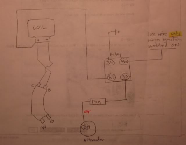

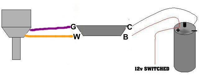

Ok now ya have needed BIG parts, (dist, and carb) install those, hopfully on a warmer day than i did it on. I had bought the DR-100 Duralast Gm Module, and I will list others if you arent big on AutoZone. (NAPA Echlin TP-45, AC Delco D-2906, or Standard- Bluestreak LX-301.) I just mounted the module directly to the inner fender well on the passenger side with machine screws ( I think I used #8-32 with matching flat washers and lock washers and nuts) using the whole tube of dielectric grease that came in the box @ that time. (think they sell it seperate now) You will need to source either the connectors from a junk GM dist or use female spade connectors, you will need 5 normal sized (1/4") and one small sized (3/16"). On the 12v side of the ballast resistor hook one wire to it and the other end to the B+ side of module. Run a wire from the C terminal of module to the + side of coil. The last connectors goes to the distributor. If the car fails to start, or runs very poorly swap the 2 distributor wires at the module. and thats it...I also bought a different coil, and I suppose any electronic ignition coil would work, but I bought the cheapest E-coil I could find, which in turn ends up being one for a Ford, Part no C-859/ FV-55. It was 14.99 when I did all this the price is up to 23.99 now according to the A.Zone site.
