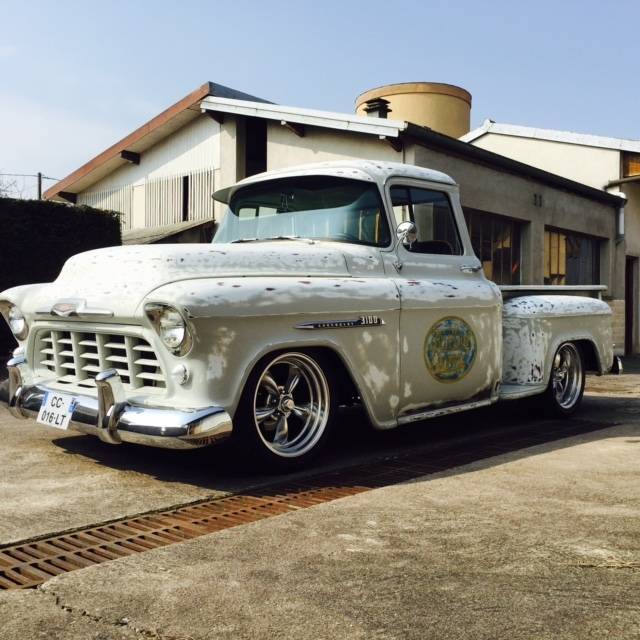

i'm from france , owner of a 1956 chevy 3100 with a 76 volare clip front end.

picture of the truck (french style restoration)

I don't know much about body work, but someone will chime in.
Just to be clear... the picture you included is your truck as it is now.
That is the correct front end sheet metal, lights, bumper for a 56 chevy 3100.
But you have a frame under that (clip) that is really a 1976 volare?
Is that what you are telling me?

yes, it'as a 3100 body , but the front clip is from a 76 volare , much people who make rods were using this kind of clips because very easy to do , and ready to use.
i have the steering system, and all the suspension system from the volare.

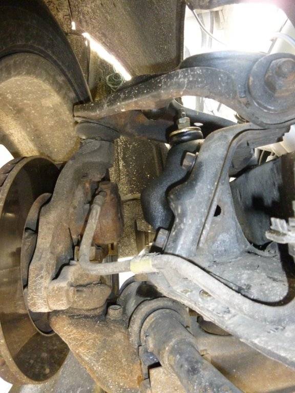

I think he`s actually looking for a rebuild kit for the Volare front end suspension(ball joints, tie rod enend, bushings etc). Like this Standard front end kit 1976 1977 1978 1979 1980 Plymouth Volare
you're right :) (my english is very bad and it's difficult to me to explain what i need , and, shame on me , i'm working for an american company : sherwin williams..)
we can forget the "chevy" , for me it's nothing else than a volare , it's a full volare clip at the front, so i'm looking for vlare parts , nothing similar with something from chevrolet. this is the good kit for volare 76?
this is the front suspension on my 3100:
thanx for help ! :)

yes, i have looked the link 7t8 gave to me. it's what i need but the problem for me is : if you enter the year , model , and make , its tell you "don't fit vith volare 76". it's the case with the ebay link, you can try.
i need all balls , steering links , schoks absorbers, all the consumable for make a total renovation of the front suspension/steering on my truck.
the 3100 transformation with volare total front clip (subframe) already get about 12 years , and during the conversion, no parts have been changed for new. so now, nothing is in good shape , and i have ordered dropped spindles for volare (fatman fabrication) , and i have to disassemble all the suspension system to put it on, so at the same time , i want to change all the consumables parts :)
i know it's difficult for me to explain clearly the problems, but my english is very far , but i'm learning every day !
