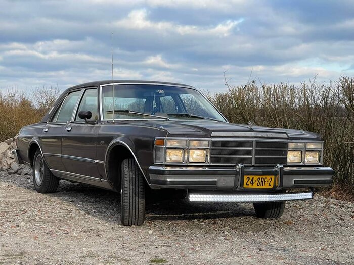

Hello everyone,
My name is Wietze and im from the Netherlands, i have a 79 LeBaron
Doing a hemi gen 3 swap right now because i blew up my mildly tuned 318
The transmission is a TCI build 727 torqueflite manual reverse shift pattern and with a transbrake.
Couldnt find a lot of information in the Netherlands that's why im here

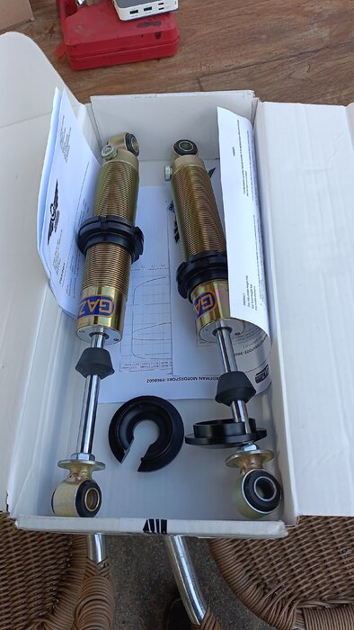

Just decided to do a front suspension swap, ordered a ifs cornerkiller setup
Should be here in a week orso

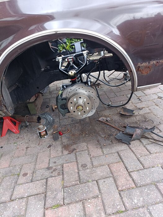

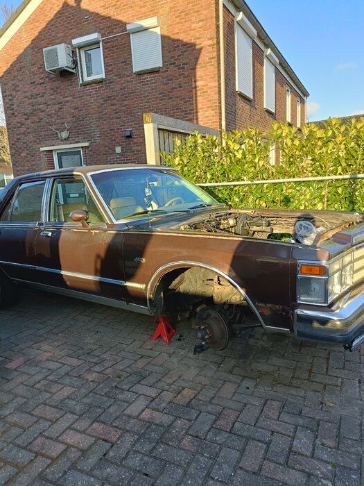

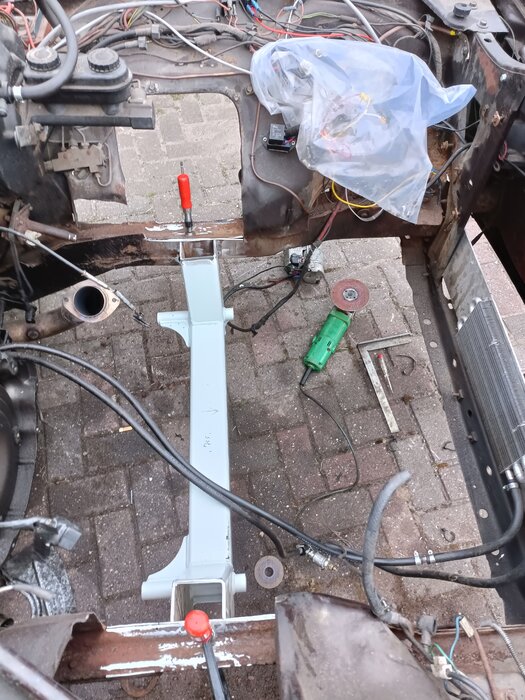

A little update

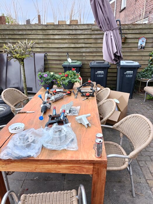

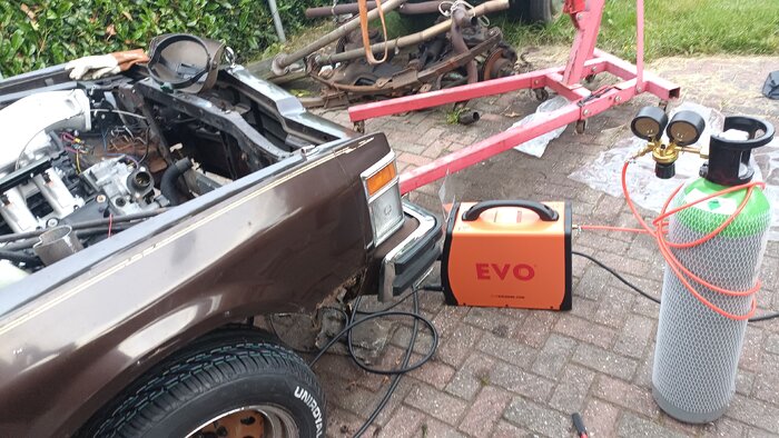

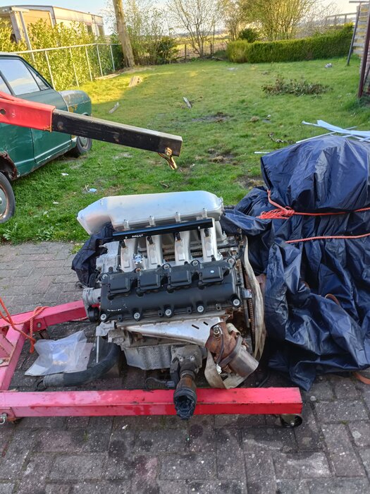

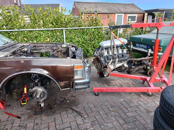

-installed the ifs cornerkiller front suspension kit

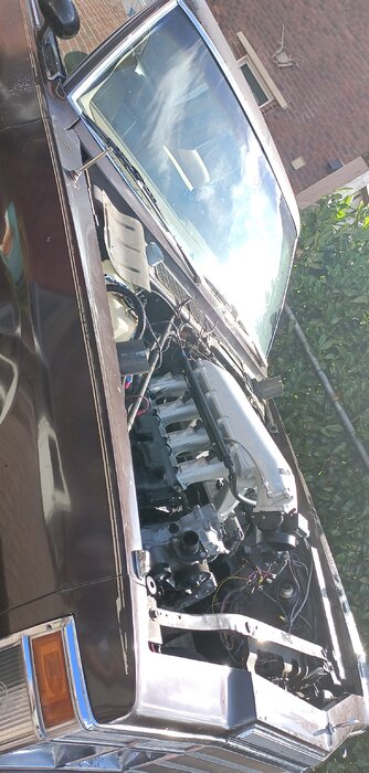

-Engine and transmission are in

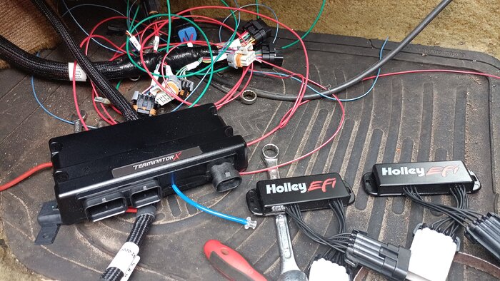

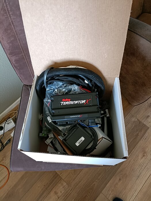

-Started wiring the holley terminator

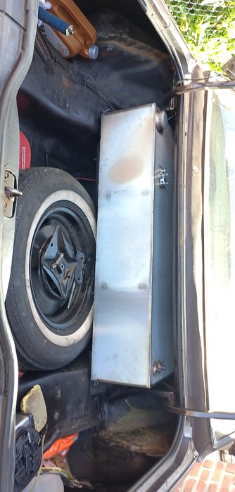

-Made a stainless 110 liter fuel tank
-Installed the holley fuel pump and fuel lines

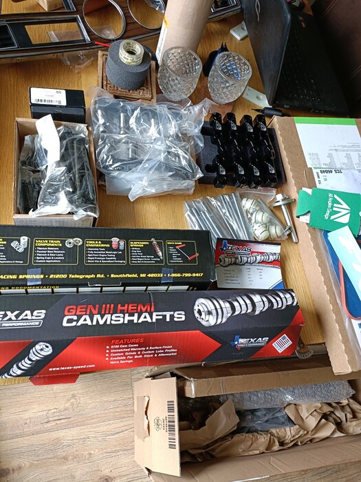

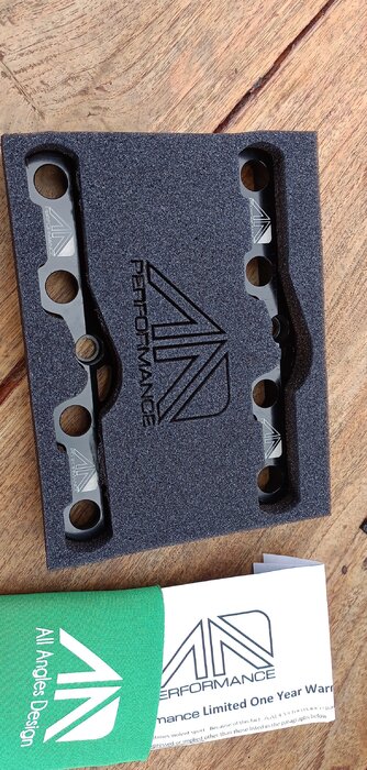

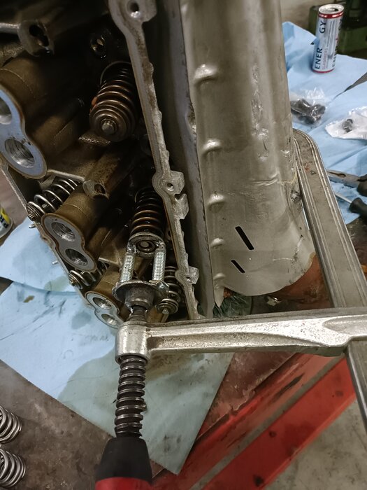

Oh also installed a FRP tomahawk cam set so deleted the mds and locked the cam phaser and got the billet bracket for the lifters

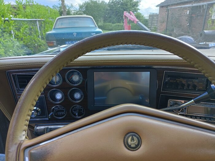

Bought a holley 7inch Dash
printed some brackets

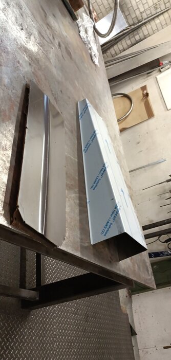

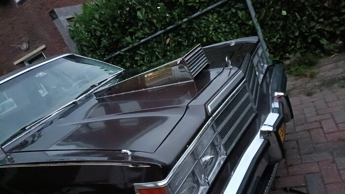

Made a custom hoodscoop from stainless mirror plate

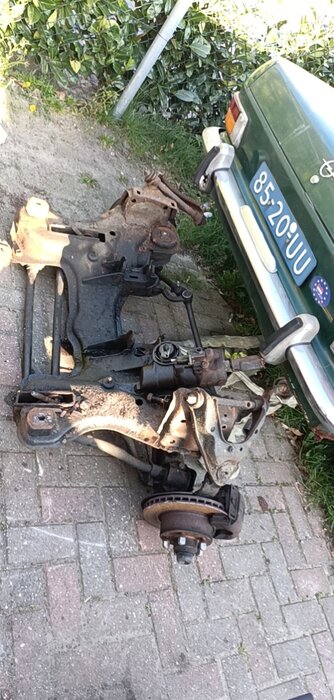

I advertised it on Facebook for free but no replys if you want you can Pick it up
