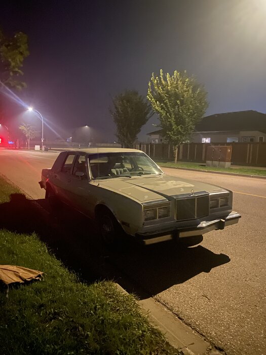

Got this 1986 Fifth Avenue from as a barn find (not running) just over a year ago for 500cad, changed oils, breaks and break lines, rat nest in trunk removal, etc. Everything you would expect
I've been driving it for over a year and have grown a love for cars in that time and came here to ask for help from some veterans to upgrade a little, I have only done basic repairs but have decided to do some more.
One: Small issue I have is a decent sized dent on the drivers side quarter panel from before I bought it. You cant necessarily "Bang it out" because the engine bay is blocking access to it, I have attempted to use a deflated soccer ball + air pump and it seemed to work to an extent, yet there is still a noticeable dent, maybe a half inch deep and five inches deep. Any knowledge you offer will be tested!
Two: For those who have replace their headliner: What fabric and glue have you used? has anyone strayed from the paths of the manufacturer and used a different fabric/texture? do you have any technique or tips you can offer? My roof is caving in on me more everyday and I'm looking for a change.
Three: Mechanically, what could I do to increase fuel economy/horsepower without having to get machinist or any mechanics work done? I am still in high school and have a toolbox in my garage, no expensive mechanic needed.
I would say I am decently mechanically inclined, but haven't got too much experience yet. Willing to try anything!
Four: What has worked in the past for lowering on a budget? Just looking to get it 2-3 inches lower on front/back.

Welcome! A picture of the dent would help. Cheap solution for the headliner is to use twist pins like here: Post in thread 'Sagging headliner' Sagging headliner
I think @MoparDan and @Justwondering have removed their headliners and would have tips on how to do that.
For better fuel economy... what's it getting now? Have you already done the basic tune up- spark plugs, wires, distributor cap and rotor?
As for lowering the car, mine had sagged out leaf springs. When I replaced them I picked up several inches in ride height and it dramatically improved the handling, noise, and overall ride quality. I'm surprised your 5th ave isn't already sagged out in the back. I can't really tell from the picture though.
lowering the front... lowering spindles or messing with the adjusters on the torsion bars?

Thank you for the reply, I was writing this last night and only had this photo, I will send more photo updates soon!
