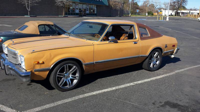

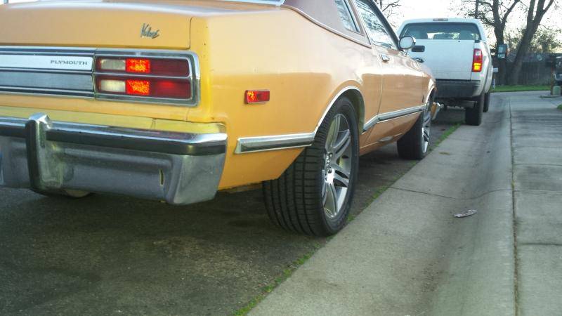

New charger wheels. 285-40-18 rear. 225-45-18 front.
Is the bolt pattern on those 5 by 4 1/2? I thought the new charger/ challenger/ magnum/ 300 was not 5 by 4 1/2?
I think the bolt pattern is 5 X 114.3 (in metric), which translates into 5 X 4:5". I think the offset would be way off; the new Charger wheels should be using an offset that has the mounting flange/surface of the wheel closer to the front side, whereas the traditional wheels have the wheel mounting flange/surface more in the middle of the wheel.
Kostas
several threads on fabo, supposedly they are 5x115, close but not exact. some say its ok some say not so much
I use 1" adapters to correct the offset. No vibration yet. Even at 140 briefly. This is the 3rd. Set of later wheels ive had on it. Only very slight rub on turn plus heavy dip.
