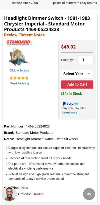

The headlamp dimmer is a separate switch, actuated by a rod. It's attached to the steering column.
Slow flashers in one direction COULD be caused by high resistance, either in the wiring, a socket, or even a faulty or incorrect bulb.
Screenshot from Parts Geek for dimmer reference.
