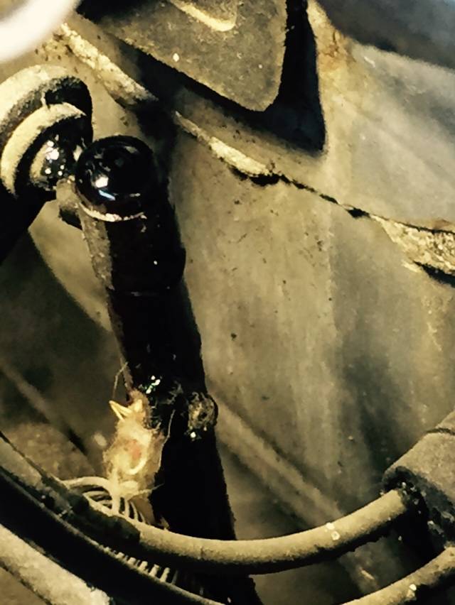

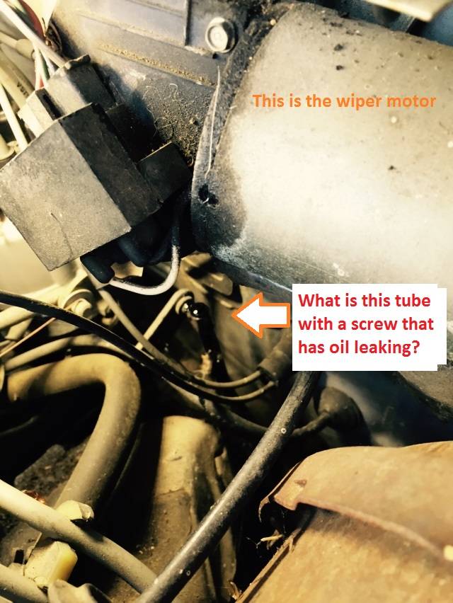

Okay, this is a picture under the hood of my fifth avenue which shows a leak. This is at the firewall. Just to the left and below the wiper motor. Its to the right of the distributor.
It appears to be leaking oil?
Here is a closeup:

The "tube" is the throttle valve rod (kick down linkage). I agree with Captain. My guess is the grease in the wiper transmission is leaking into the motor and then oozing out the case.
