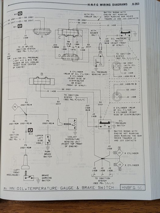

doe anyone have a diagram for the Oil Pressure Gauge ? i'm trying to get me car together. no sender in it. key on, the oil LIGHT is on and the gauge is at 1/2. unplug the gauge and the light turns off.
i cannot find it in the 1980 service manual.
Diagram from the 1980 factory service manual:
If it is for a factory gauge then the sender is different from the one with just the light.
