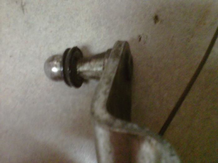

When I pulled my motor and tranny I noticed one of the clips holding the rod to the clutch fork was totally missing... I found a service kit located on e-bay and Mancini racing...they list a P4529447 for B and E bodies and a P4529489
for A bodies...this is a picture of what I am talking about...

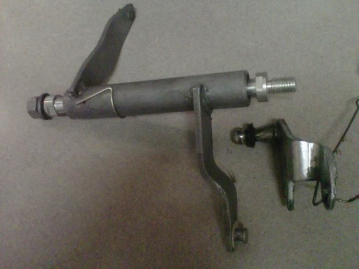

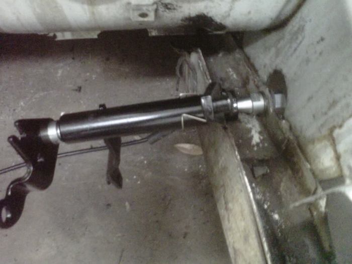

I did some late night checking..
The B-body z-bar service kit I bought for the car will work...I may have to drill a round hole in the bracket that is on the frame rail but oh well that will be another day..I dry fitted everything and then took some pics..the bracket that attaches to the tranny had the pivot ball joint rivot to the bracket..I will have to drill out the rivet and use a nut...

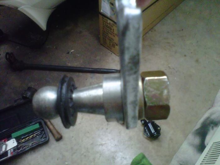

I forgot this one
I drilled out the old swivel ball joint and inserted the new one with some blue lock-tite and a lockwasher and nut..
