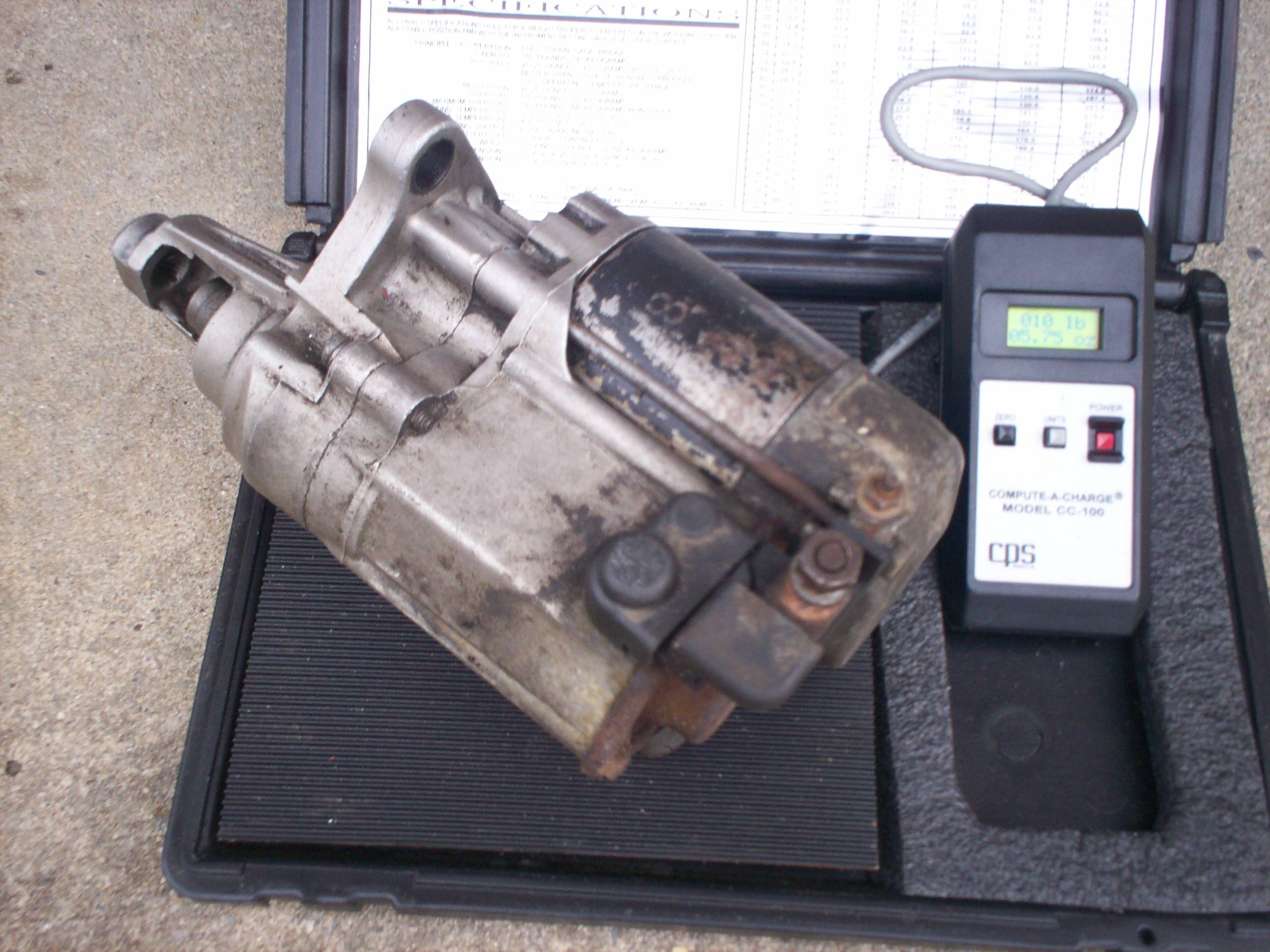

Old direct drive type. Big, heavy and requires moving the exhaust.

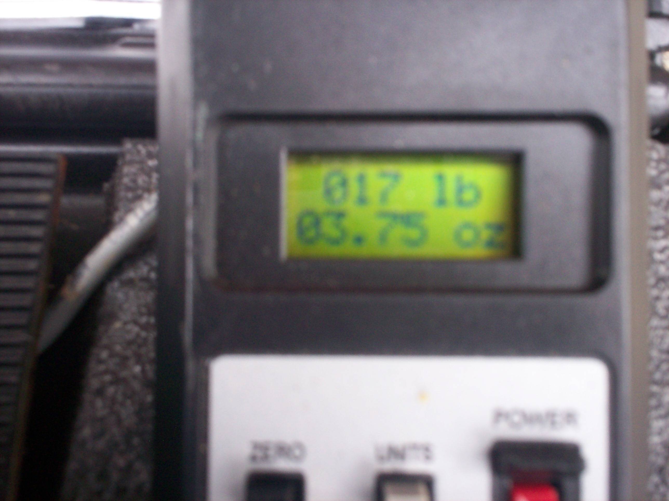

That is more than 17 pounds.

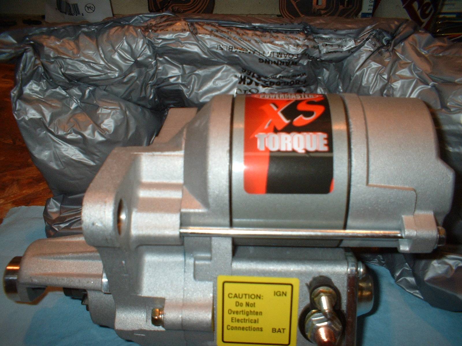

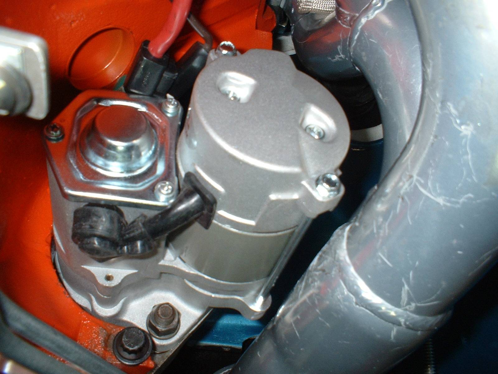

Here is my re-purposed one from my other engine- half the size as the old one.

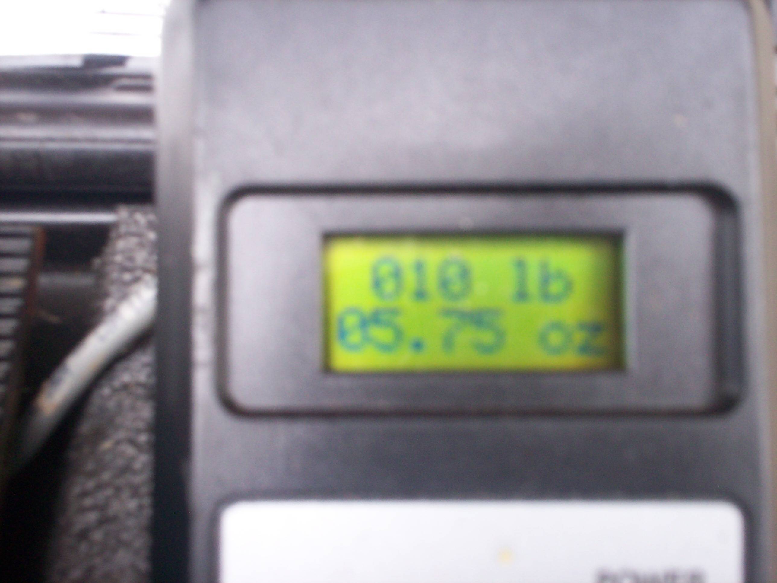

And just over 10 pounds.
So the new one is almost 7 pounds lighter and spins faster at less the current draw. WIN WIN WIN
