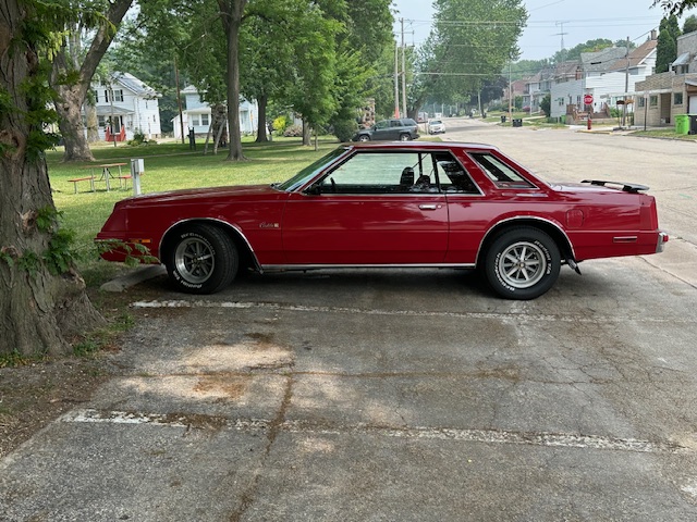

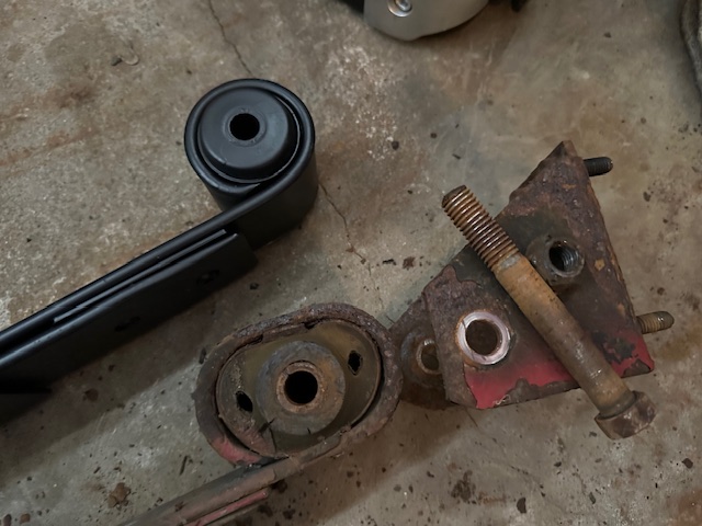

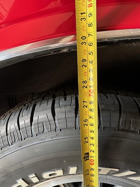

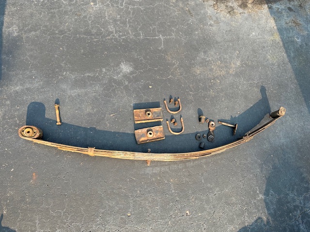

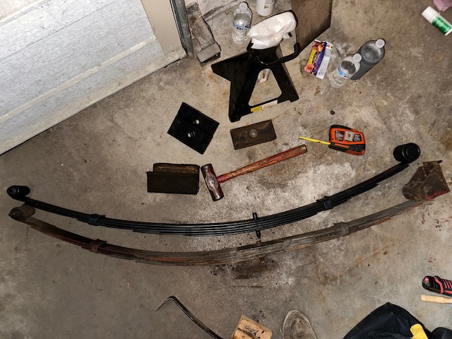

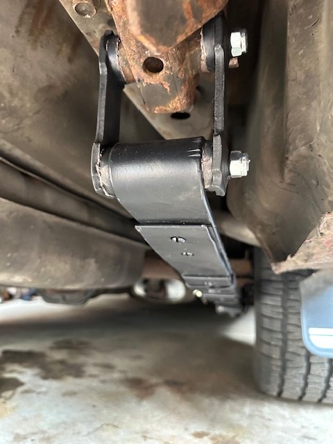

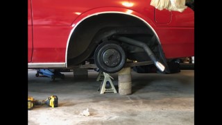

The above posts are spot on and if I had that advice 2 years back, that might be me. I only drive about 2,000-3,000 miles per summer. I wanted an offset look... what I did is likely not the best set up, but here is what I did. Car was all stock. My back leaf spring were badly bent since about 1984 (long story and long trip with trailer I got stuck towing and bottomed out for 400 miles as kid). I lived with limping along with air shocks for years and light towing, but still saggy. With a fully loaded car and trunk with cooler and swap meet cast heads in the trunk with a couple more car parts...trunk and back seat full and 2 adults. Even with air shocks full to max, I bottomed out hitting my mufflers at least 20 times on the Pennsylvania turnpike when I ran the 235/60/15s on all 4 corners...loved the tires, but I needed to replace the bent leaves. Last summer I replaced the leaves with Eaton Detroit Spring new leaves with 1" extra and made as heavy duty. Put on BFG Radial TAs - 245/60R15 in front that are 26.6" diameter and spec said 783 REVs per mile. I put 275/60R15 in back for the offset and taller look. Those say they are 28" tall and 743 REVs per mile. Still had room to leaf where a 295 would have fit, but my rims are not wide enough. Like others said, my speedo is off until I fix that. I calculated and also timed it so that I could make my adjustments for speed... I think about 5mph off at highway speed. I love the look. I love the firm feel of new leaves. I did not bottom out. I did not cut any sidewall on my Pennsylvania Turnpike run with minimal air (like 50 pounds) in air shocks. I did put new air shocks on just as protection in case I get stuck adding too much weight to trunk or towing heavy tongue weight trailer. I am happy with the results. Likely not for everyone. I still tow an old boat with lots of tongue weight, so I just fill the shock halfway to 100lb and it looks as flat as with no trailer and minimal air. I will try to find and load some before and after pictures.
