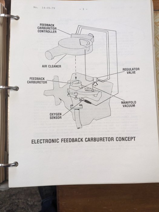

1979 Volare and Aspen models equipped with the 225 engine, one barrel carburetor, and California emissions package included an oxygen sensor, an electronic feedback carburetor, additional modifications, and components to interface with the Electronic Spark Control. Other applications in 1979 did not use this oxygen sensor, etc.

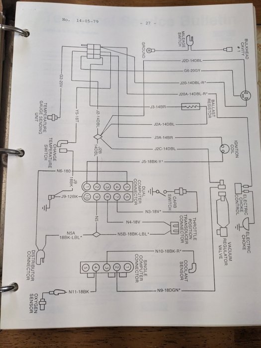

Following are select images from the 27 page 1979 Technical Service Bulletin (TSB), number 14-05-79 about the system. If equipped, the sensor is positioned in the exhaust manifold as shown in the diagram and connected to pin #4 of the single row connector at the combustion computer.
