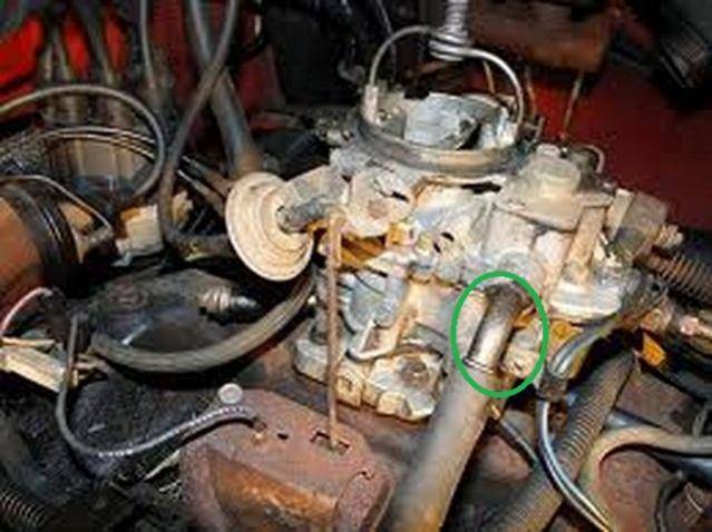

This may be sacrilege to post here, but I've transplanted a 318 from a 5th Ave into a 1966 Coronet.
My plan is to give one shot to hooking up the factory lean burn, as the engine ran GREAT while it was in the FA. If that fails I have a 73 2 BBL to swap on, and if that fails, plan C is to go ahead and install an Eddy intake and 600 CFM 4 BBL.
I have a FSM for the coronet for the harness pinout, and a Haynes for the FM/J body that has wiring diagrams.
What I don't have is specific fuel system plumbing for that 318 carb.
Right now, my main concern is that the fuel filter has three ports, and that there is a large diameter (larger than the inlet) line with nothing attached, right at the top front of the carb.
Do these two connect, as a partial return? Anyone got a pic?
Thanks much.

I believe that is just a vent tube, that may or may not have been ran down to a charcoal canister. Pics would be a plus. I am not for sure about the 3 ported fuel filter, but I would doubt that the 2 would be connected.
Terrible pic, but this-
I think you might be right about vent to charcoal can.
Now about that third line on the fuel filter- could that be a return to the tank?
Would it be safe to cap that, or just replace the filter with a "standard" one?

I took my rubber line of the return line and left it open to atmosphere at the frame rail. My charcoal canister and anything that was connected to it is gone.
