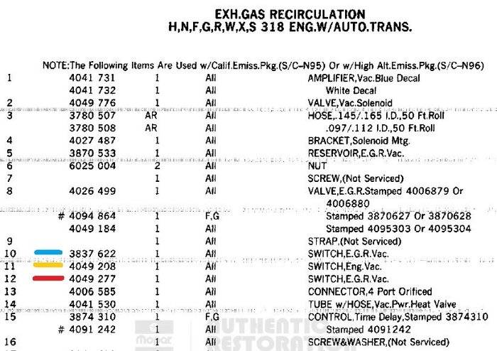

Darnit, I don't have a '77 parts catalog.
However, Napa and Carquest/Advance can get them. They are sold by the color of the plastic and number of ports on the originals vs vehicle specific listings. The originals were color coded the same way as the aftermarket replacements so, if you have the original switches, it's possible to get new ones by just matching them up. If the colors are the same, they will work the same way and at the same temp. They generally run between $35 and $50 each, depending on the switch.

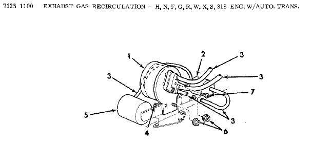

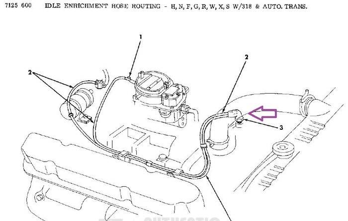

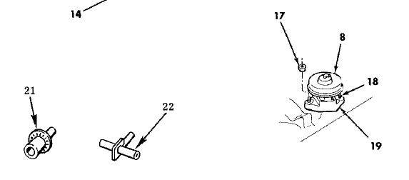

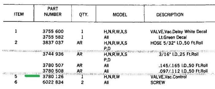

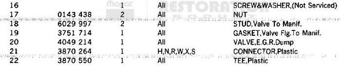

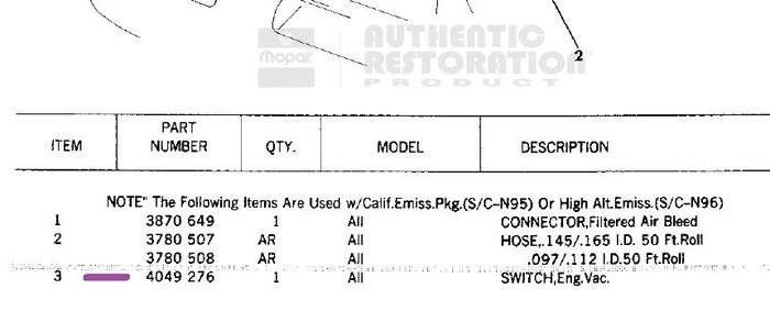

1,492
Idle Enrichment

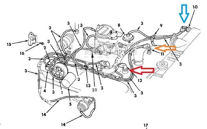

Spark Advance
EGR
Hope this helps.
