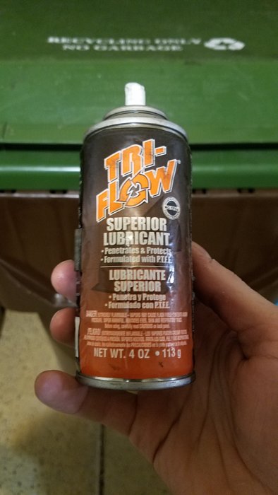

Hey guys, sorry to bring up an old thread but I found a solution to the problem after reading the WD-40 suggestion... I had this spray lubricant (WD-40 is not a lubricant) lying around and decided to give it a shot. I sprayed it into each latch as I worked the lock up and down, after a bit of that I tried the lock switch... FLAWLESS. Try it out on your sticky locks, no disassembly required! Not to sound like a friggin infomercial lol...

It is not a lack of lube, per se, on old latches - but the existing lube turns solid (or solidifies).
The latch needs fresh lube – but generally inside of the door where the spray cannot get to, without removing the door trim panel first.
