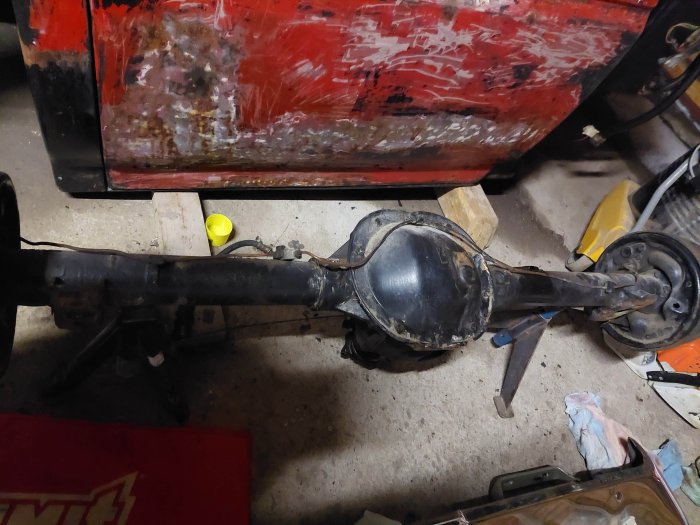

In 1993 I had a new gearbox installed. The VIN number says I had A998 as from the attached photos. No change of propeller shaft as far as I remember. Rear axel 7 1/2".
I can get a 8 1/4" locally that was on a station wagen, Diplomat. Looks nice. He has the propeller shaft so complete so to speak. Gearbox 727.
Will the original propeller shaft fit or does it have to be altered? What is the difference between A998 and A727? I have not the faintest idea so please advice.
The combination A998 and the propeller shaft from A727 to the 8 1/4" has to be changed or fit straight away.

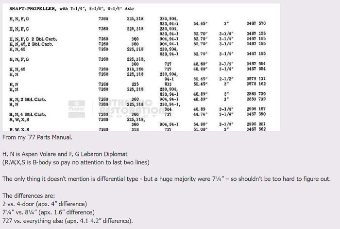

Thanks for your help. The penny drop now. A shorter propeller shaft for the 727 and longer for the A9 series. That means my shaft should
be a straight fit according to the picture below.
No, you have a 7 1/4 rear axle and are switching to an 8 1/4. The 8 1/4 has a longer pinion housing. The 7 1/4 drive shaft is too long. It will not fit.
I'm doing the same swap, but for a 4 door, on my Diplomat. If you try and bottom the driveshaft out and force it to work, there will be no room for movement on the slip yoke and you'll destroy your transmission.
