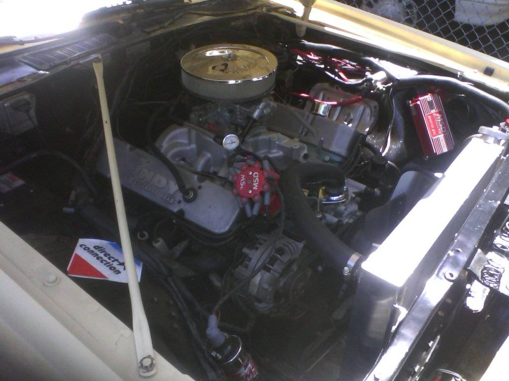

I just wanted to say thanks guy for the info it was very helpful & post a picture of the engine installed !

nice. put a bigger filter on that and the the beast breathe.
