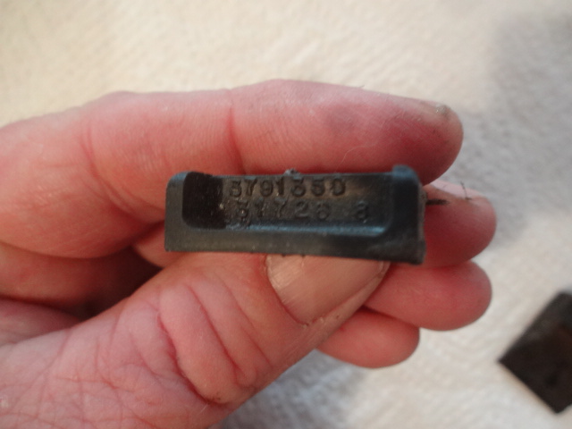

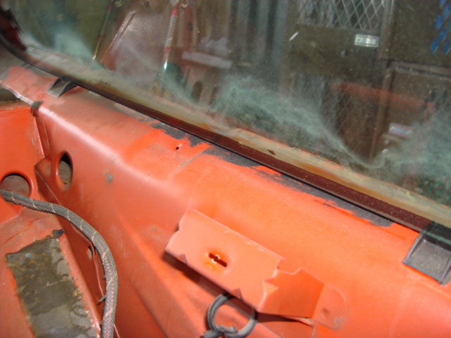

Do you mean like these? The center one not seen is held down with a screw. If these are what your talking about I think ive got some.

Sorry JW, I didn’t get around to getting the quarter interior pieces off yesterday, I was painting the kicker panels and rear seatbelt plastics and it got dark out.

Thank you for uploading pic fast, those are exactly the clips I need, those two black plastic clips. I have the metal center one that isn’t shown, the black clips broke while removing window/louver many moons ago. Am I able to buy those online, is there a part #?

I briefly looked in the book, I think the PN is 3791350. I looked online and zip. I recall some out of the car I can look this weekend or maybe even pull a window from a parts car. Not sure how easy a window would come out in the cold though. But something tells me I might have some already out. So keep looking but I will look over the weekend.

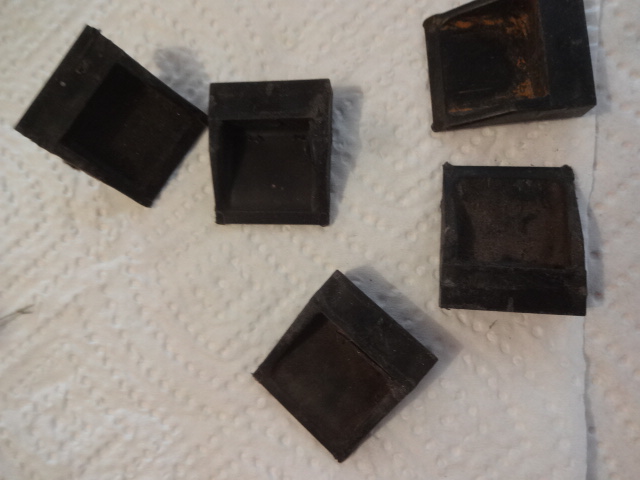

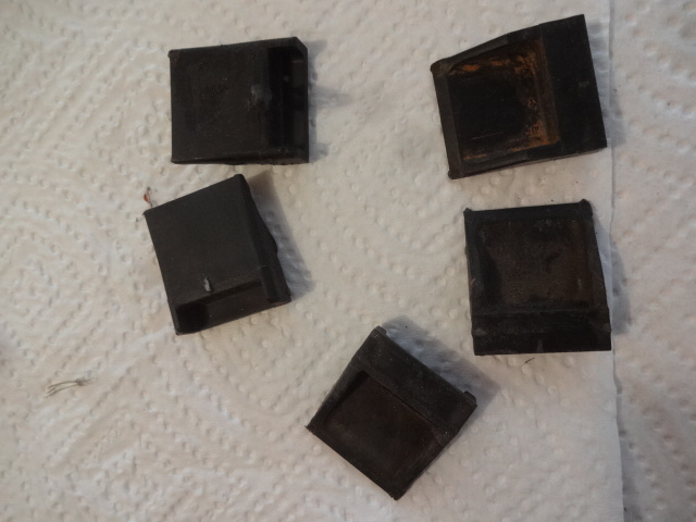

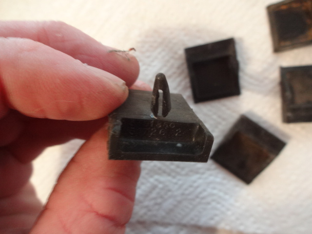

I found them. Wont feel my fingers till tomorrow but.....

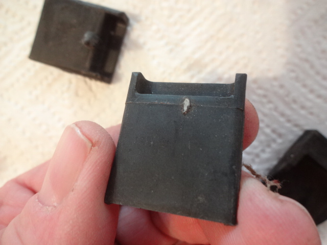

The llil tab that comes off them always breaks, I just drill a tiny hole and use a lil sheet metal screw.
If you can use and want two of these just pm me where to send them. Regionally im close to you.
