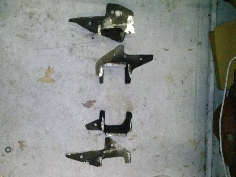

I belive the Center to Center is 13 3/4"
The top piece pictured is the outside driverside.
Then the inside driverside.
Then the inside pass side.
And, u guessed it, the outside pass side.

Thanks for the visual! I'm starting to think, in this order:
- forget the entire project, it's not what I was looking for.
- swap the whole K
- use a plate
