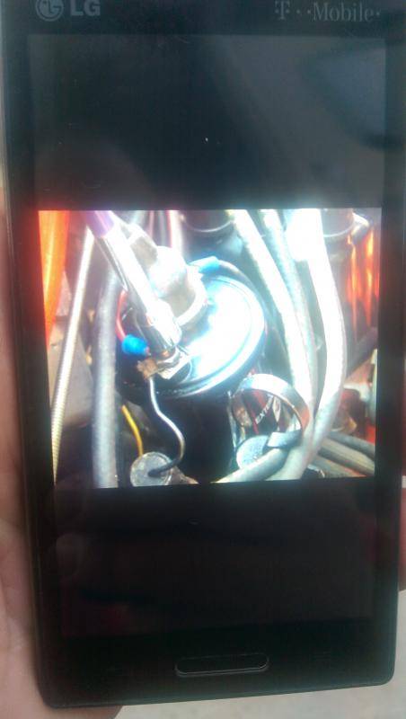

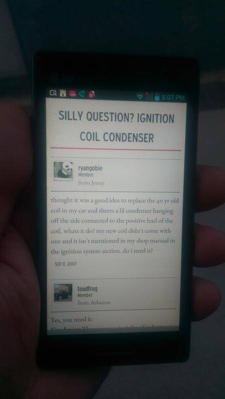

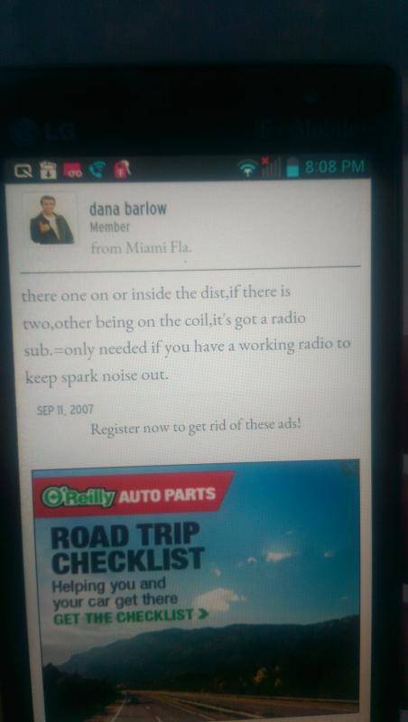

The white ceramic ballast?
Condenser to my brain is showing me the little one in the distributor of a points ignition.. lolol
MiradaMegacab
Feb 27, 2011
1,847
753
Long Island NY
I googled ignition coil condenser.
IDK how to post a link
8v-of-fury
May 7, 2014
435
40
Orillia, Ontario
Ahhh, ok. I saw those but they just looked like the ones from points ignitions so i omitted them from my searches.
