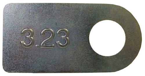

The first thing that needs to happen is to find out what your current gear ratio is. Some of these cars came with a tag located under one of the 10 rear cover bolts and looks like this:
That tag goes missing often and somewhere around that time, Chrysler quit using them (so no worries if your tag is missing).

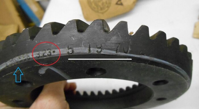

The next step is to remove the differential inspection cover and look for stamped numbers on the ring gear. The stamping will give you the part number (blue arrow - not important), the ratio (in a x.xx format, red circle) and date the ring gear was made on (white line).

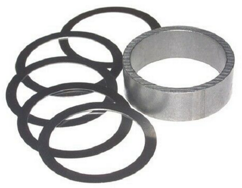

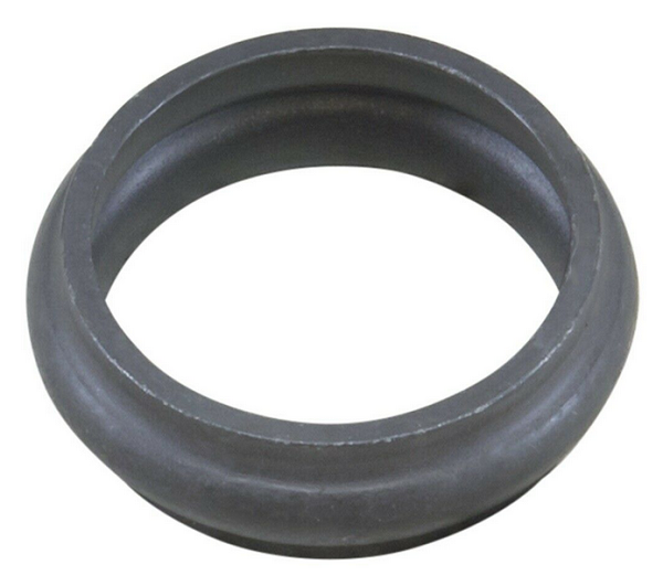

One last thing, If you are planning on some very hard driving (ie: clutch drops, neutral slams and so forth) where the rear differential will see a lot of hard and sudden impacts like that, I would also recommend getting a crush sleeve kit (using metal shims to replace the crush sleeve). If you just plan on normal driving on a /6 or 318 2-bbl, then the normal crush sleeve will work fine.
Normal crush sleeve
Aftermarket crush sleeve elimination kit.

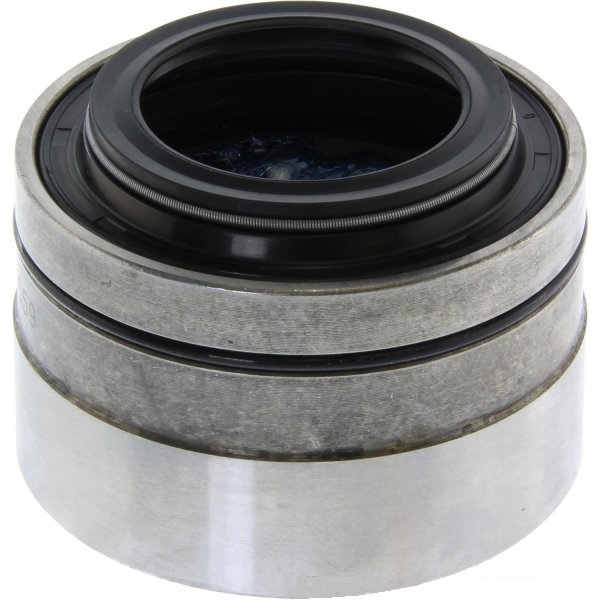

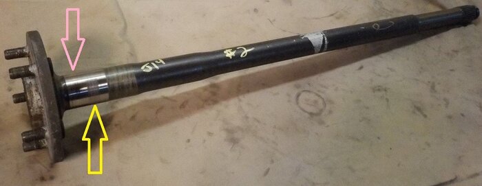

You have to remove both rear axle shafts to perform any differential work, Check the axle shafts where they make contact at the axle bearings (and axle seals). If you can catch a fingernail at either surface, then you will also need to replace the axle bearings (arrows).
Until recently, you had to also replace the axle shafts, but the aftermarket has came out with new bearings that contact a different area of the existing axle – which is very nice.
Note: it does take a slide hammer and a special tool to extract the old axle bearings.
A person might be able to rent this (maybe).

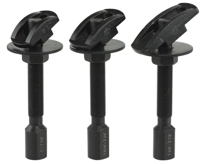

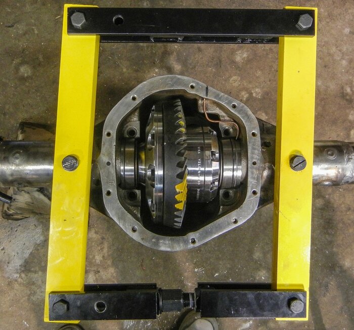

The 7¼” and Dana 60's are a different animal. Those require a case spreader and a large assortment of adjustment shims to get correct
