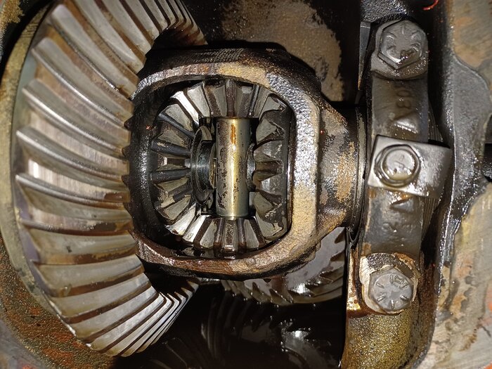

This is the inside of my 7 1/4 after cleaning it. It's pretty burnt up and worn out, but it still works and I can still drive the car while I rebuild an 8 1/4 on my porch (kinda cold out) Sometimes keeping the car moving keeps the project moving

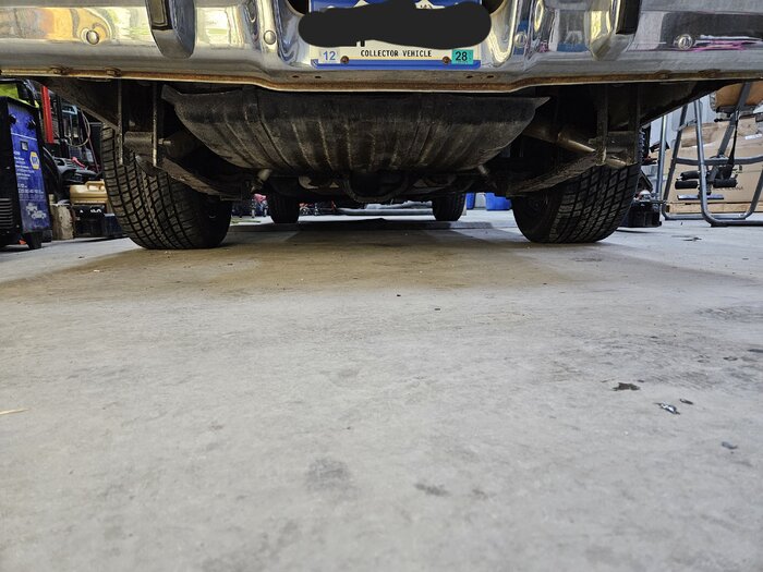

The Dana 44HD out of a ZJ is very close on width and will take the OEM back plates & drums. Obviously have to lose brackets and weld on perches. I think I paid 150 for the used axle. My '78 SE was originally a 318/904 car with a 2.73 ratio 7.25 incher.
The ZJ 44HD were mostly 3.73 posi units, which is how mine came. When I swapped in the 511 stroker, I changed to 3.07 gears to get some top end back, since it will roast them through 1st and into 2nd anyway.
The 44HD pumpkin is what was used in the Viper, FYI.
This is with Cooper Cobra 295/50-15s on Cragar 61015 wheels
They do stick out a little, wish there was a 5.25" backspace option, but 4.25" was it for this style in 10" width
